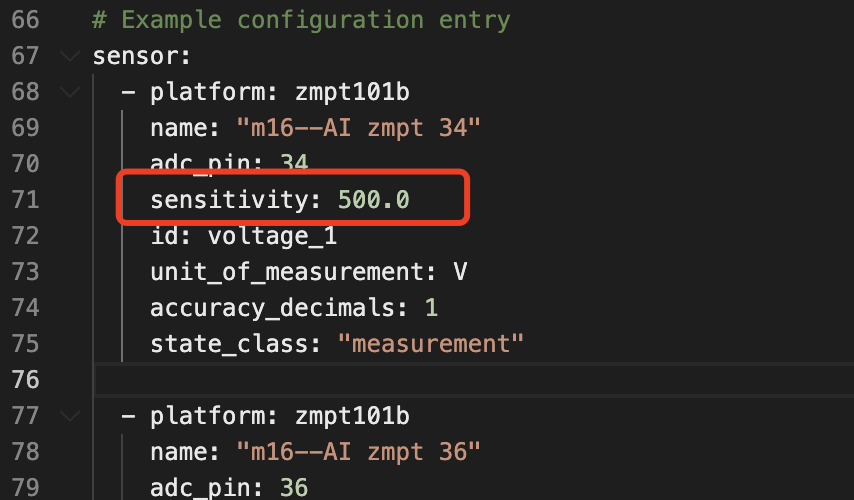

add this "sensitivity" to sensor code. set to 500.00 re compile , have a test.
sensitivity: 500.0

Added as you wrote now with voltage of 218 volts the values ​​jump within 198-225 volts not stable
#38
you can change the parameter. how to calibrate the voltage, see this link: https://www.kincony.com/forum/showthread.php?tid=3764
just use arduino program to find the "sensitivit" value, then replace in esphome yaml file.
