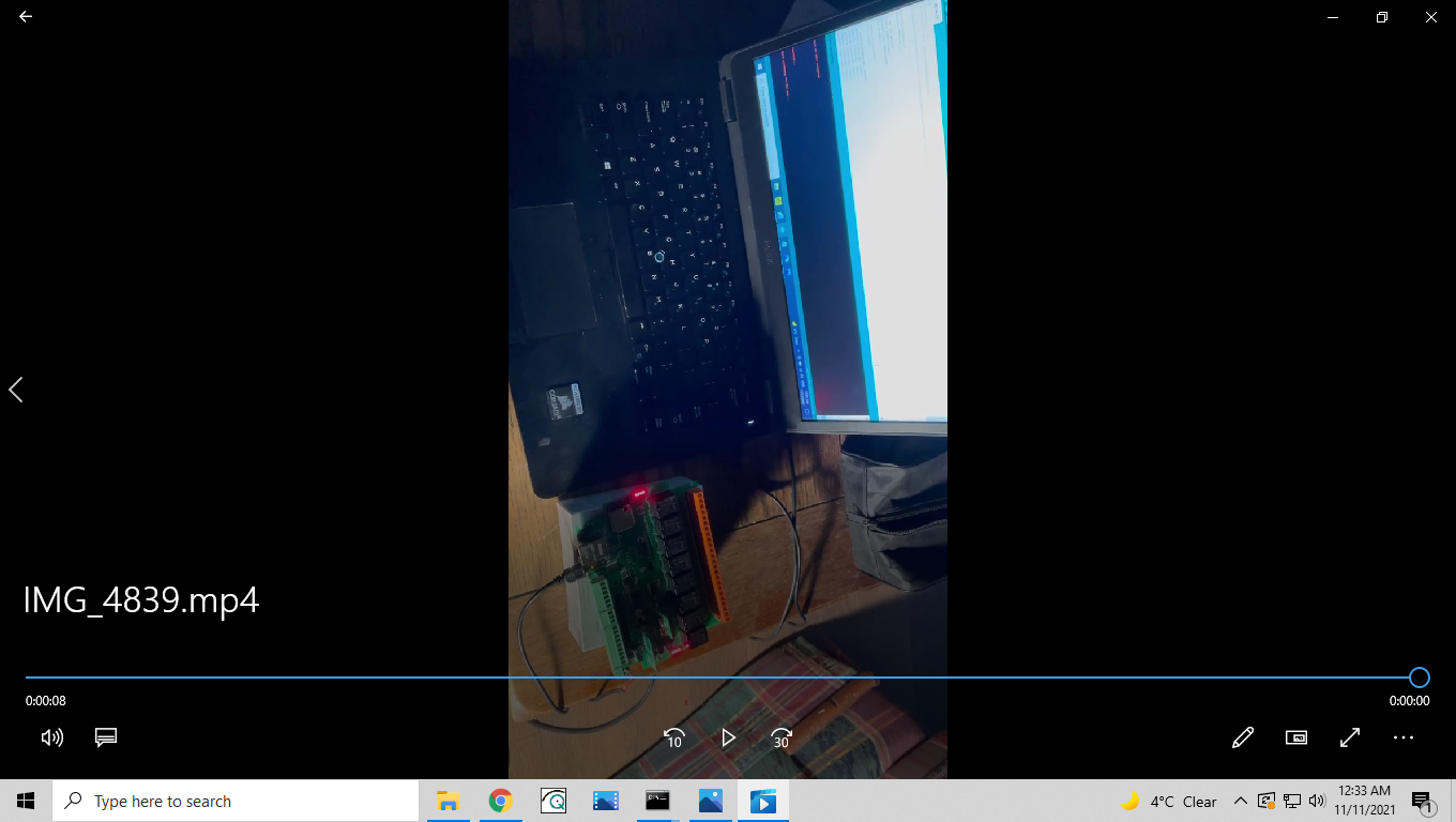

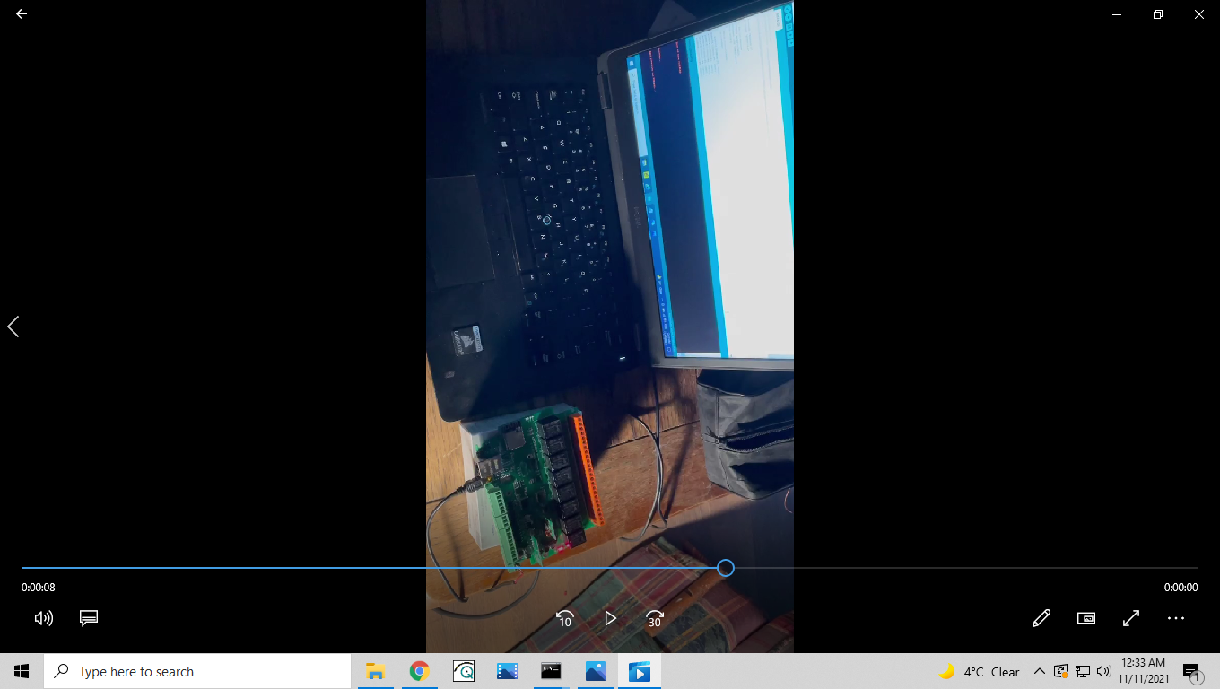

had to change variables pins_in arduino.h (as suggested in video) for SDA =4 and SCL=5 from original values.
everything works great.
video upload of kc868-a8 relays performing would not work.
couple of pictures to suffice.
