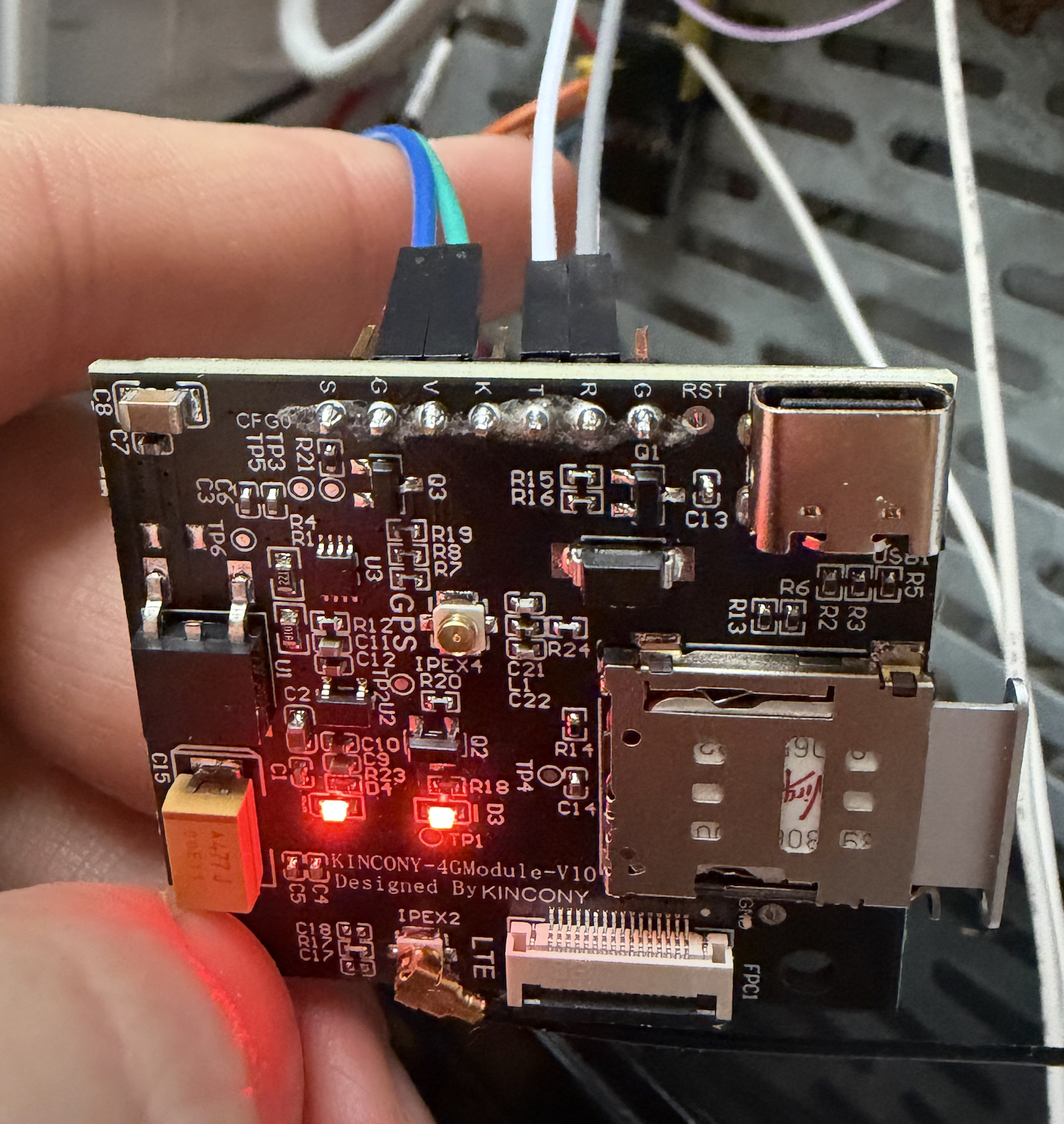

Hi. Module working connected directly to PC via Uart Assistant tool.
But can't call via a16v3 board. Connected to GPIO40 - RX and GPIO41-TX as you maintained in previous comment. Configured as on https://www.kincony.com/forum/showthread...t=sim7600e

#14
do you use by KCS firmware or your own software code?
#15
(11 hours ago)admin Wrote: do you use by KCS firmware or your own software code?
KCS firmware and integrated with ESP Home.
Nothing changed on sim7600e module.
#16
you can test by this sample using ESPHome: https://www.kincony.com/forum/showthread.php?tid=6503
