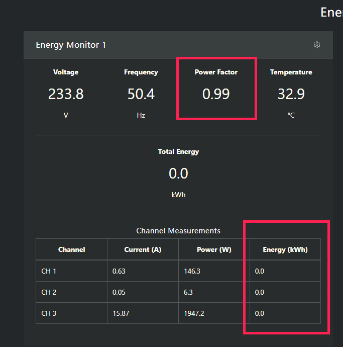

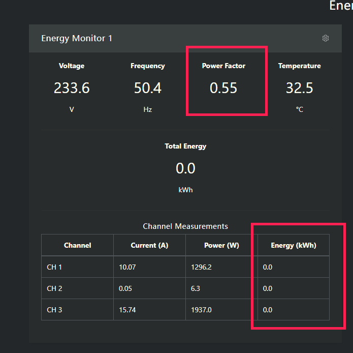

I updated the N30 with the firmware and reset the strange large numbers.
Looks better but did not checked it with a noon power device.
But still no energy enteties
[Image: Screenshot-2026-01-07-181202.png]
What is with the power factor, what is the function? Why is it changing?
Looks still not functional, should I return it?
