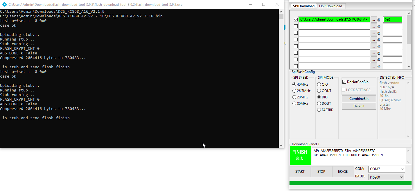

I flashed this software (   KCS_KC868_AP_V2.2.18.zip (Size: 784.65 KB / Downloads: 53) ), but the esp32 does not come in AP after restart or reset.
feedback when bin-file is flashed to the board
it have showed download successfully. you need power off->on of your board. then login by ethernet webpage or wifi AP webpage.

what's firmware file name you have downloaded? your photo can't see the file name.
KCS_KC868_AP_V2.1.9.bin but I also tried KCS-KC868_AP_V2.2.18.bin
