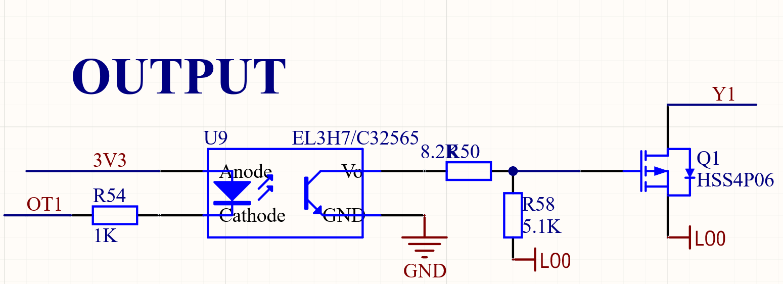

output by P-Mosfet
(03-21-2026, 11:40 PM)admin Wrote: output by P-Mosfet

here is T16M every channel mosfet output diagram:
(04-03-2026, 11:06 PM)admin Wrote: here is T16M every channel mosfet output diagram:
