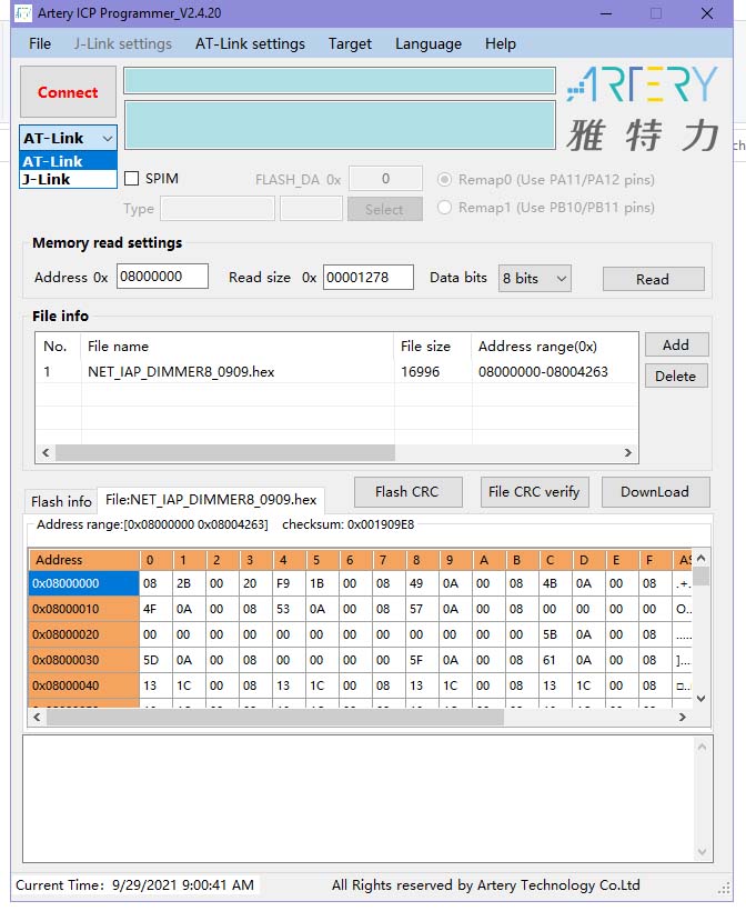

B. if your dimmer controller MCU chip is "AT32F403AVGT7"  use AT-Link or J-Link to download bootload HEX file.
[Image: AT32F403AVGT7.jpg]
Here is AT-link tool for KC868 smart controller firmware update.
https://www.kincony.com/download/ArteryI...2.4.20.zip
when download at AT-link software , MCU chip model will auto detected when update KC868-D8
if you want to order AT-link usb cable, here is order link
https://www.aliexpress.com/item/10050033...2bd5m3SIcY
if you use J-link, you can also use AT-link's software download firmware by J-link. But we have not sell the J-link.

I am just looking at updating the firmware following the above information, I have checked and I have a AT32F403AVGT7 chip, so I need either a AT-Link or J-Link cable.
When clicking the link on the above tutorial page to buy the AT-Link cable it states that the cable is no longer available. https://www.aliexpress.com/item/10050033...2bd5m3SIcY
Is there another way of getting the AT-Link cable or another cable that will accomplish updating the firmware? I have searched for the J-Link cable also without any success.
Any help will be greatly appreciated.
take a screen photo of your firmware version, we need confirm. When you bought KC868-D8?
unfortunately I wont have access to the webui for around a week, from memory it was 3.x sorry I cannot remember the second digit, it may have been 3.4.
The webui only had around 10 lines of setting, there was definitely no MQTT setting options.
I will try and get a screenshot uploaded as soon as possible, I was hoping to order the cable if needed whilst I was away.
i think you need to use AT-link or Jlink to download the bootloader firmware. Now you can visit AT-link product webpage link again, it's avaible now.
Hi,
Thanks for your help, I have now received the AT-Link cable, I was just wondering if there is a step by step guide to follow for flashing the KC868-D8 using the AT-link software?
I see it has been requested in a previous post though I could not find any other information, I just don't want to do something incorrect and brick the device.
Thanks for your help.
