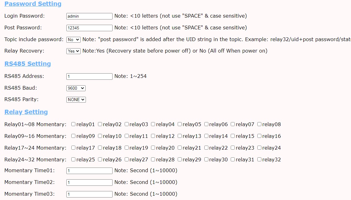

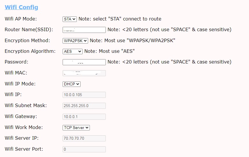

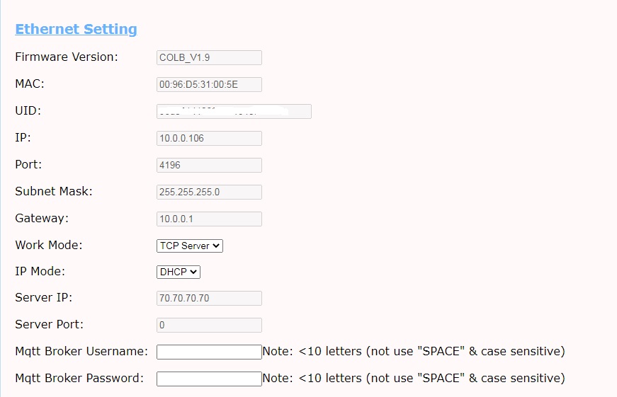

s
s
[anexo=588]
does not respond to modbus command....
What is the calculation used for CRC code?
KC868-COLB's RS485 use for KinCony's RS485 energy meter, now you use RS485 connect to H32BS, do you want use COLB automatic control H32BS output? here is video tour: https://youtu.be/Obo3YHj2A6k
i don't know what function do you want? can you say clearly?
In the demo video you get an example of a modbus command, what is the calculation used for the CRC value, this heat changes with each command...?
To use mqtt and Node-red with COLB controller, how to read analog values?
To control the outputs of the H32BS through the logical values of the COLB, via rs485, must the ethernet and wifi network be disconnected?
1. by CRC16 modbus RTU. there are some modbus tool will auto add the CRC code for command.

3. if your H32BS automatic control by COLB via RS485, not need ethernet or wifi.
example: if the controller is connected to the network and receiving commands through Node-red (mqtt),
does this interfere with rs485 communication?
qual a tensão para entradas análogicas?
if use MQTT by network, not need to use RS485, only use ethernet cable is ok.
