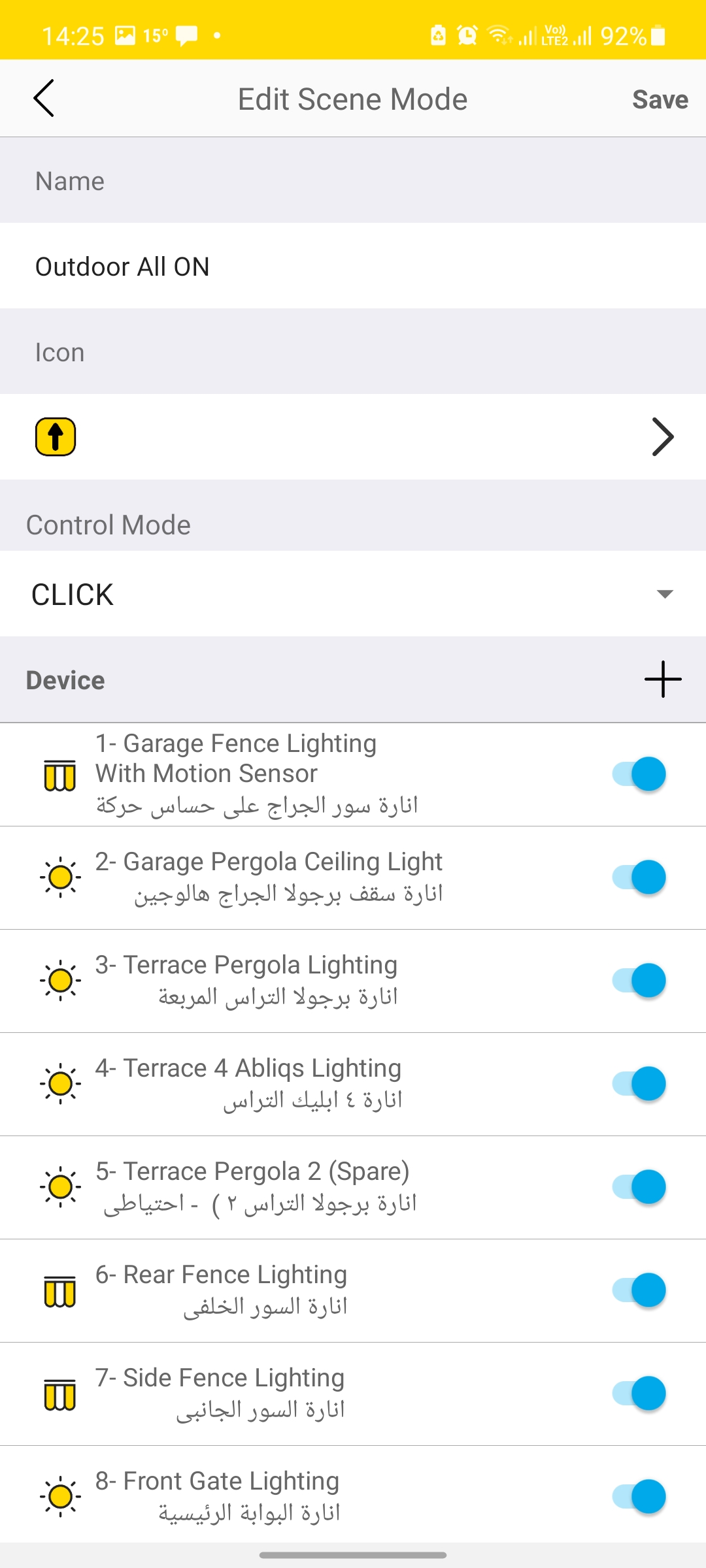

2. The sene is not work neither for original mobile nor the other family mobile.?
3. Sometimes kbox is not responsive quickly and hanging (stop function -no response or delay?
4. Changing the channel name on the original mobile is not updated to other mobile you still can control from different mobiled that copied the QR code of the device but can't see all update done on the channels name including the scene created?

        Scene not working in both original mobile and other shared mobile ( see attached log file as you suggested in item 3).
4. followed the video and used restore configure data from original phone not update the new name channels in the original phone ( see attached log file as you suggested in item 3)
6. Kbox-pad installed not able to communicate with the controller no input configuration to select and communicate with the desired controller using ip and port pls see attached photo
#19
1. how to create scene mode, can you take a video send to us?
2. after you restore, close the app and re-open again, whether see new device?
3. your photo pc software is old version for COL, not COLB's new software, if you are using KC868-H32B , you should use https://www.kincony.com/download/KBOX-Pad.zip
