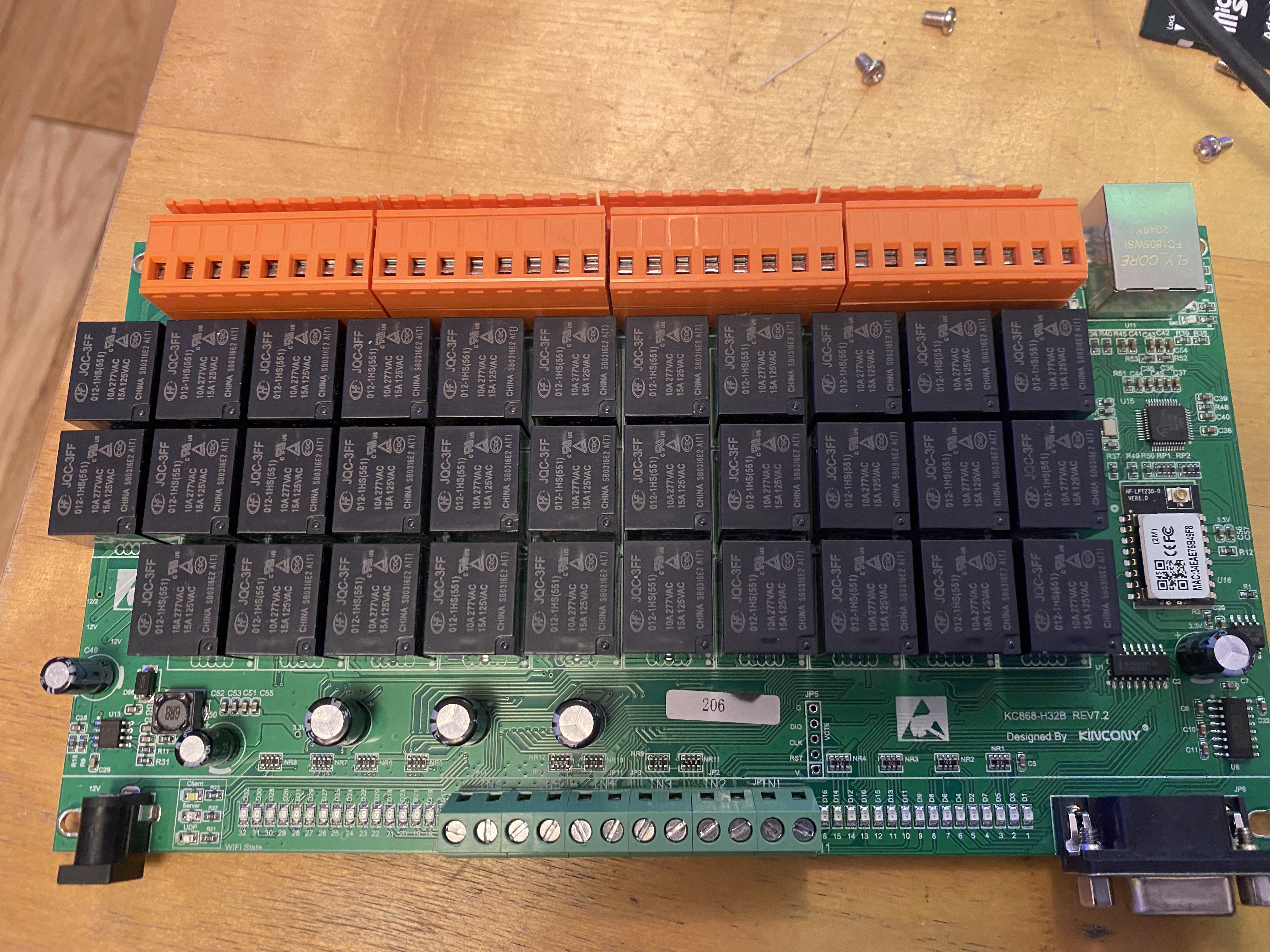

(03-09-2022, 10:54 AM)admin Wrote: you can upload details, so that we can try to help you. now i don't understand your questions.
there are H32L and H32B all have broken?
#13
it have overload, we suggest you replace the PCB, if you want to try fix it. you can use wire welder with bad pin, because your PCB line is already disconnected.
#14
