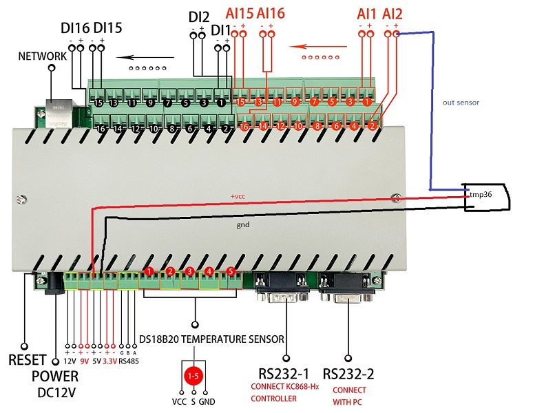

I bought DHTM-02S (analog sensor for temperature and humidity) and TMP36 (analog temperature sensor).
I connected the power supplies on the + 5v and gnd pins of COL. the analog output of the sensor on A1 + of COL.
with both sensors if I measure with the tester I have 0.6V on the analog channel.
I tried to change the coefficient from COL but I can't set them correctly.
is the analog output of the sensor on A1 + correct?

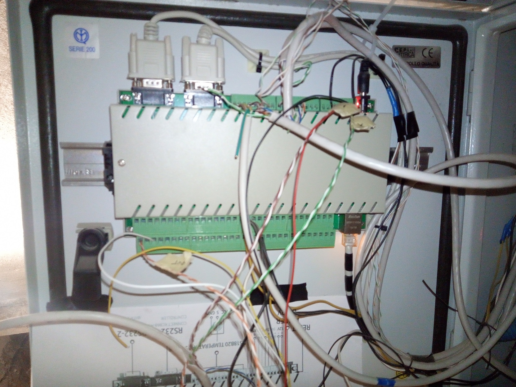

Do you using KC868-COL or KC868-COLB? you can take a photo of your device.
use KC868-COL. attached photos. you can see the sensors connected to the 5v power supply and the input signals on AI1 and AI3.
"coefficient" is use for UI window to display, not for sensor setting. You should chose DC 0-5v analog output type sensor.
