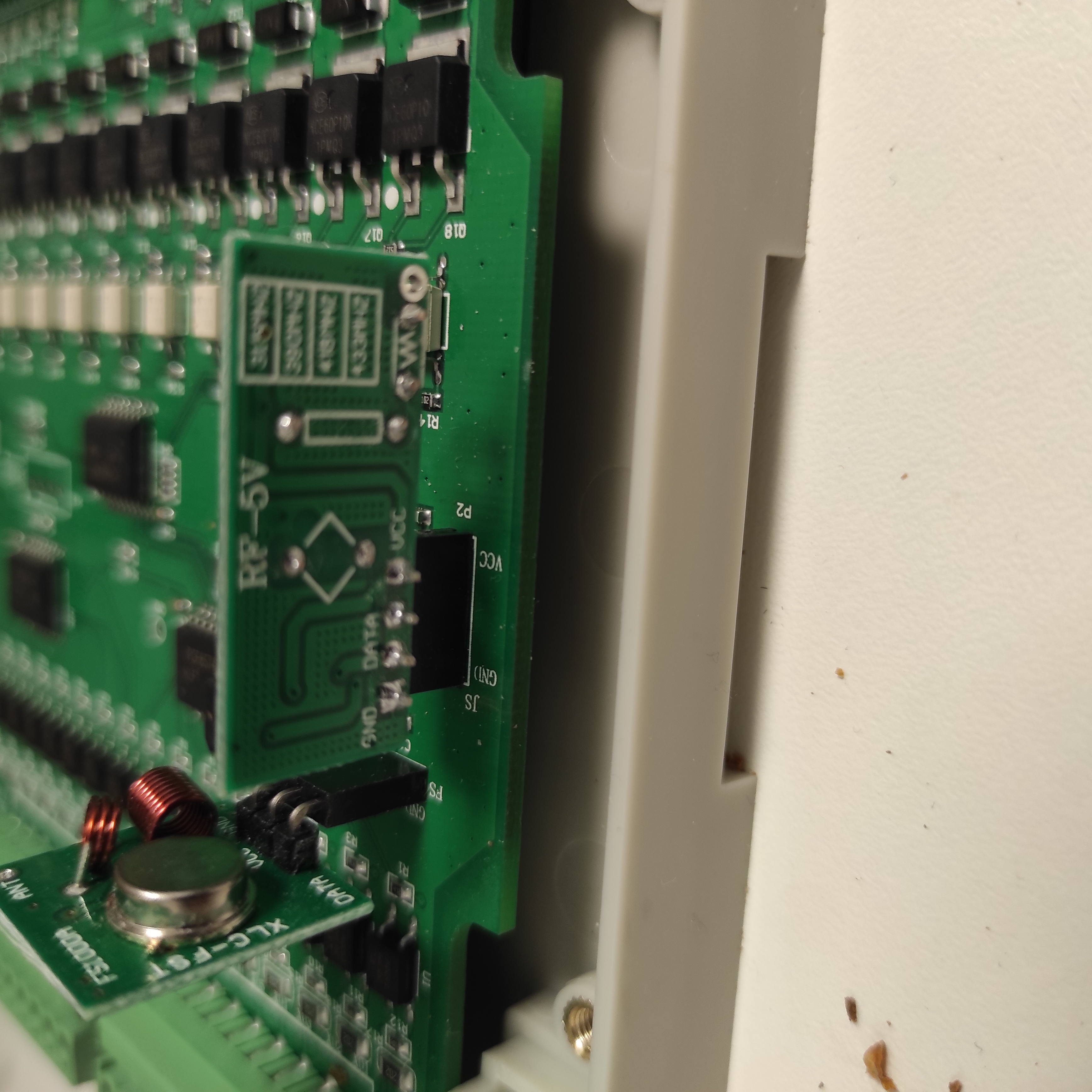

(03-17-2022, 11:13 PM)admin Wrote: i seen the video, now take a photo of your A16 pcb receiver module.
These are the pictures
K868-A16 433 RF MHz receiver
03-17-2022, 11:20 PM
(03-17-2022, 11:13 PM)admin Wrote: i seen the video, now take a photo of your A16 pcb receiver module. These are the pictures
03-17-2022, 11:59 PM
your transmiter module is install direction is reversed, it's wrong. i suggest you remove your transmiter module (the smallest square) for a test.
03-18-2022, 11:08 AM
(03-17-2022, 11:59 PM)admin Wrote: your transmiter module is install direction is reversed, it's wrong. i suggest you remove your transmiter module (the smallest square) for a test. I did the test without the transmitter module but the codes are still not visible in the LOG

i think you can test whether have signal output in RF 433MHz receiver's "DATA" pin.
03-18-2022, 02:28 PM
(03-18-2022, 02:07 PM)admin Wrote: i think you can test whether have signal output in RF 433MHz receiver's "DATA" pin. Can you be more explicit please? The RF receiver has 4 pins. From what I saw one of them is connected to GND through a resistor on the back of the PCB. Between which pins should I measure the signal and what should I expect to see?
03-18-2022, 09:58 PM
the pin "DATA" with "GND" , whether voltage will changed when you press the remoter's any button.
03-18-2022, 10:35 PM
(03-18-2022, 09:58 PM)admin Wrote: the pin "DATA" with "GND" , whether voltage will changed when you press the remoter's any button. I did the test. No button pressed on the remote control the values are: GND to DATA = 3.57 V, DATA to VCC = 1.38 V. When any button on the remote control is pressed the values are: GND to DATA 3.59 V (sometimes 3, 60 V), DATA to VCC 1.38 V. The conclusion is that when you press a button on the remote control the only value that changes is between GND and DATA, from 3.57 V it becomes 3.59 V or 3.60 V
03-18-2022, 10:54 PM
1. Monday confirm with you. Because use oscilloscope is the best way, now you using Multimeter measurement.
2. Do you only have 1 433MHz receiver module? no another module for a test? 3. Do you have connect the receiver module with wrong reverse install as same as the transmiter module before? |
