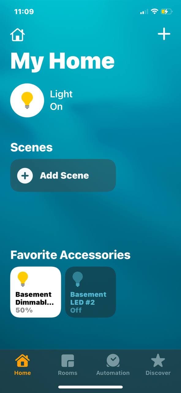

Kc868-a8
adruino ide installed
ch340 usb serial driver for laptop pc
completed lesson1 config:
https://www.kincony.com/forum/showthread.php?tid=281
lesson 2 and lesson 11. Can write sketch to esp32 no problems. no relay lights or clicking when reboot .
lesson 11 when watching serial monitor:
all commands can be seen passing through on lesson 11 from apple home app on iphone.
bad gateway when trying to connect from laptop to esp32 web ip address
(serial monitor) switch shows on and off when using example workingled sketch, but no relay activation or led lights on kc868-a8.
all communication shown in serial monitor , when using example monitorlogging sketch.
simple lesson 2 circuit not working, tested several times.
do I have to place
https://www.kincony.com/forum/showthread.php?tid=282 pin #definitions somewhere within sketch file?
Status and Control LED pins are listed as undefined in Serial Monitor running lesson 11.
Help appreciated.
