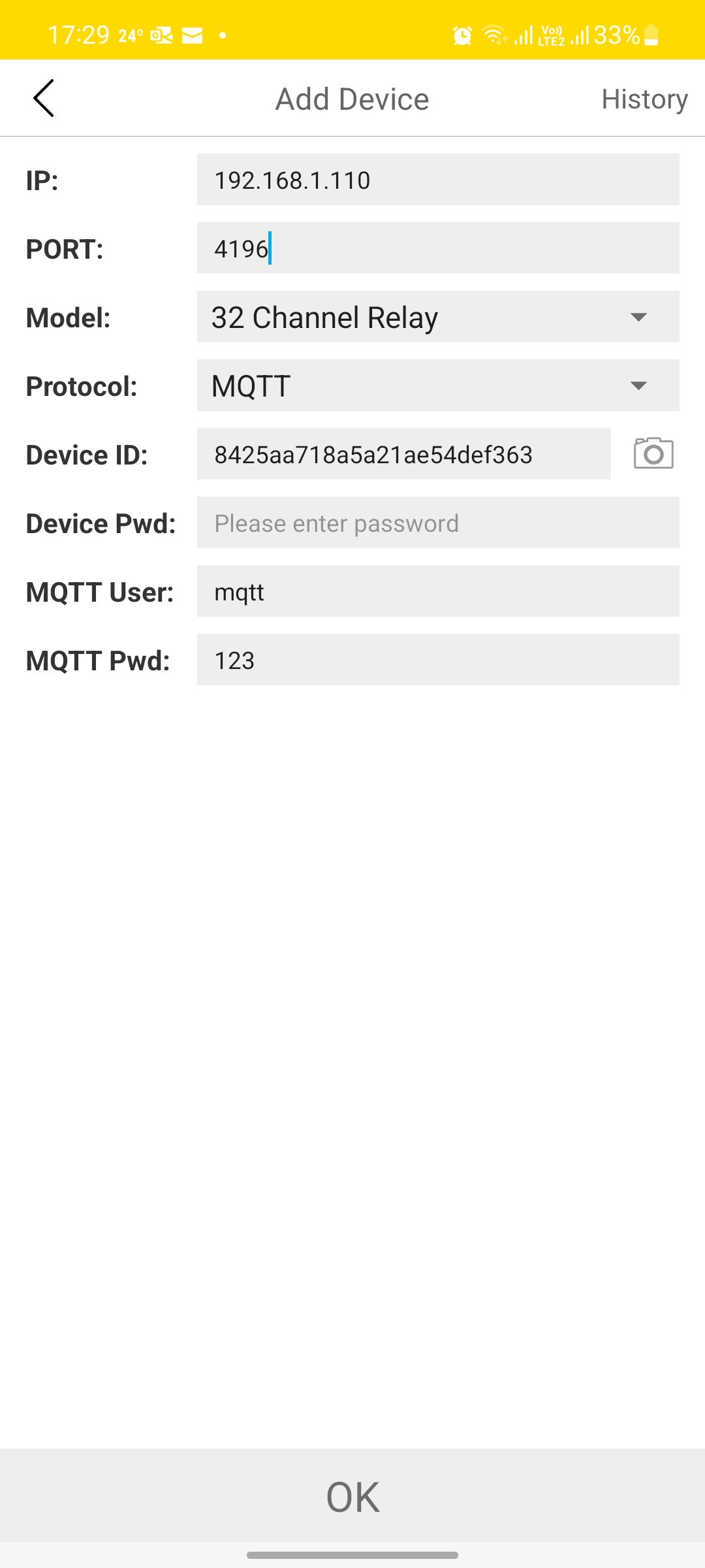

6. Kbox-pad installed not able to communicate with the controller no input configuration to select and communicate with the desired controller using ip and port pls see attached photo

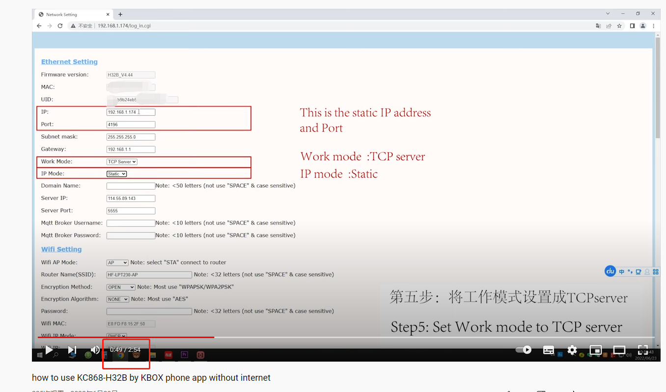

2. The kbox can control the H32B but i can't connect to the H32B web page
The ip scan is showing ip is 192.168.1.12
But the web page give error!
How can i rest the H32B to factory setting?
#27
1. whether need add RC snubber according to your load. if connect with a AC contact load, (coin inside, inductive load type) , then need add RC snubber. it according to AC or DC load and load type. because inductive load will have interference when ON/OFF.
2. your computer and H32B should in same local network. what's your computer IP address?
#28
(07-21-2022, 11:41 PM)ahmedk4444@yahoo.com Wrote: Please confirm and solve the current/ previous discussion:-
1- the load less than 4A each , then based on last trail with you no need to relay and load connected directly to H32B 220 v .
Then in this case no need for RC snabber.
Please confirm
https://www.youtube.com/watch?v=Yn0yTdkN_Kw
Follow the instructions in this video. it will tell you how to scan the ethernet IP address and go to the web page to set parameters.
The principle is simple: Connect the network cable, open the scanning software, search for device IP addresses in the same LAN, copy the IP addresses, and open the web page to enter the setting page
if you want to use KBOX,the the WorkMode to tcp server and the ip mode set to static(can't conflict),alse you can set wifi to TCP server mode ,then the port maybe is 5555 not 4196,and the iP mode alse set to static
if you want to use smart home app via ethernet ,then set ethernet work mode to UDP,and ip mode to DHCP, and use KBOX via WIFI,then set wifi work mode to TCP server
if you want to use KBOX via MQTT,then set the ethernet work mode to MQTT,input the server iP an port.

please find attached the configuration reset it
come to 192.168.1.25
i fixed the ethernet to mqtt static 192.168.1.110
wifi to TCP server DHCP
please review and confirm the configuration is correct to use KBox through and without internet on the 4G
.pdf   H32B Graden web page config and controller - 20220723 to Kincony.pdf (Size: 650.79 KB / Downloads: 1,227)
