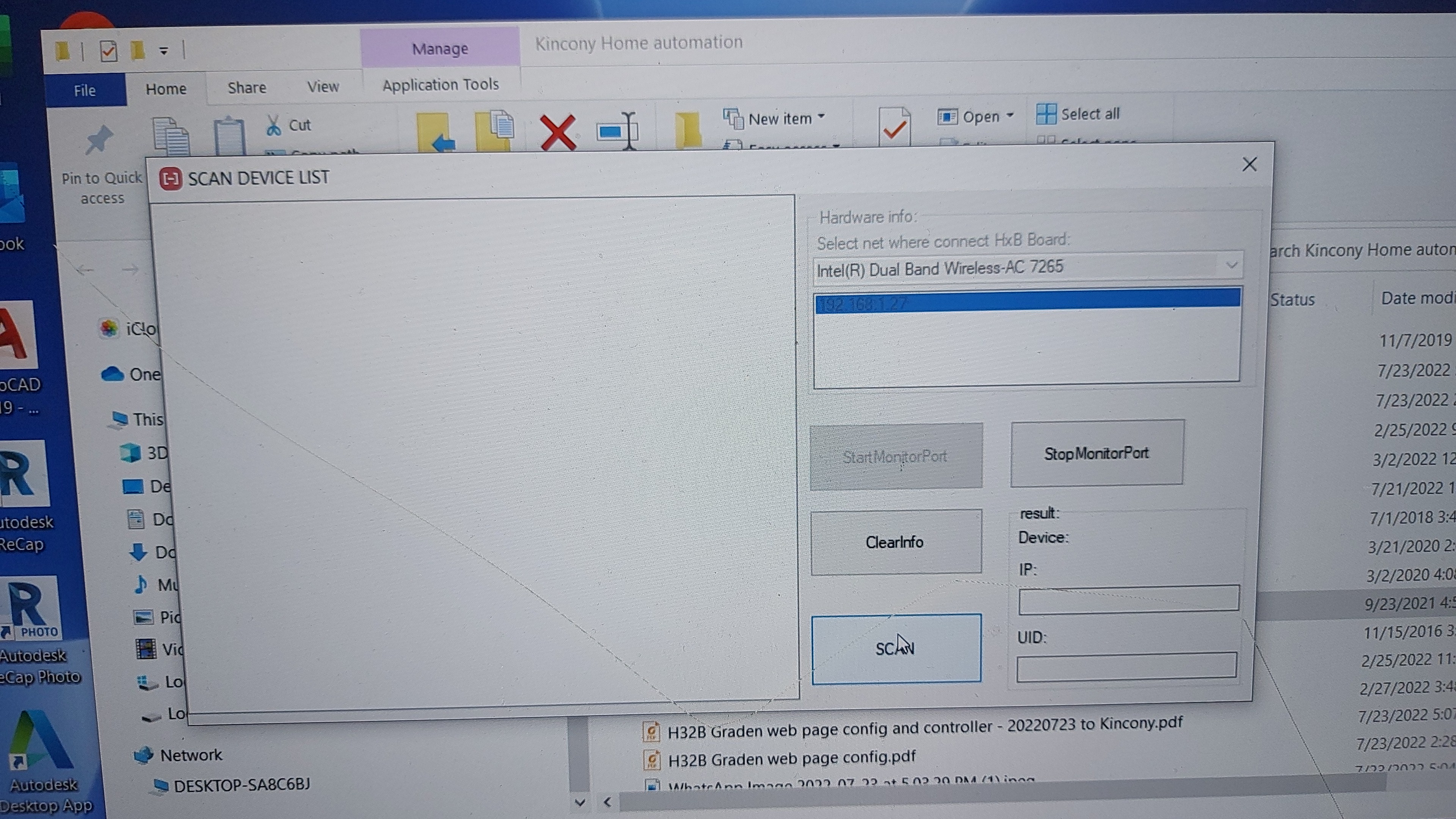

Last chat with kincony support
We agreed to uae mqtt for all eyhernet controllers and for wifi conyrler TCP server DHCP
H32B is now mqtt for ethernet 47.96.253.237 port 1883
But
Then based on that both D8 don't have wifi only ethernet mqtt static ip 192.168.1.120, 130 port 4196
And using for mqtt 47.96.253.237 port 1883
Status no communication by kbox only remote and one click switch.
Also H32BS mqtt static ip 192.168.1.140 port 4196
Status no communication by kbox also the remote not working i only connect the 12 v input to test and learn remotes yes only one button as you said.
See photos for curremt status and led

#36
