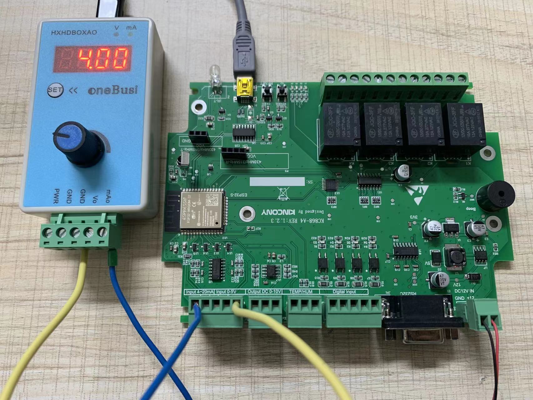

actually esp32 will convert current signal to voltage from sensor. we have tested KC868-A4 board with current source, here are some photos from board and esphome log output:
here is ESPHome config file for KC868-A4 analog input:
