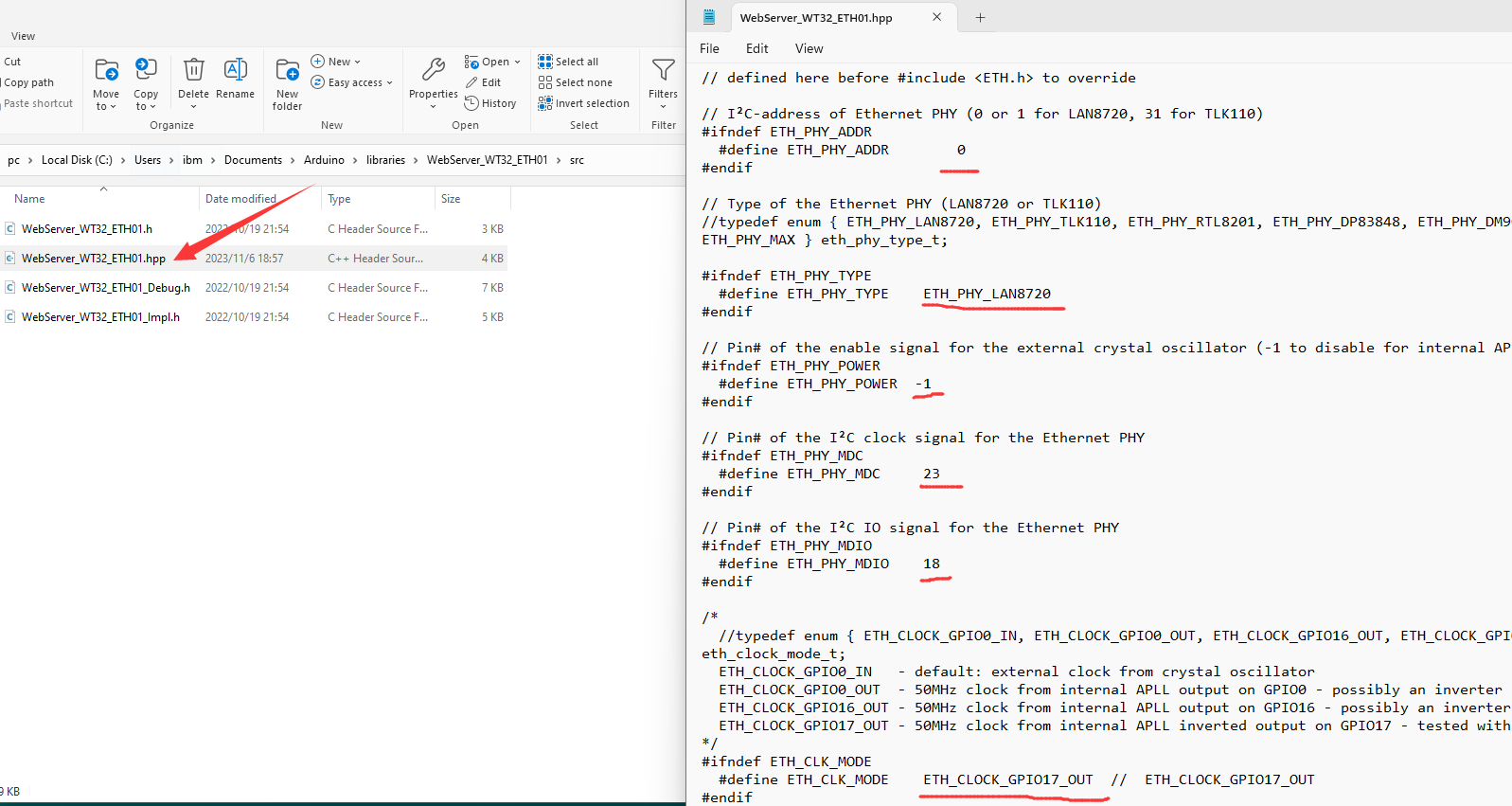

this is userful for you:
KC868-AI ethernet web server source code download:
https://www.kincony.com/forum/showthread.php?tid=2249
make sure your "WebServer_WT32_ETH01.hpp" file config as red line in photo.
arduino web service library download:
.zip   WebServer_WT32_ETH01.zip (Size: 296.89 KB / Downloads: 1,117)
