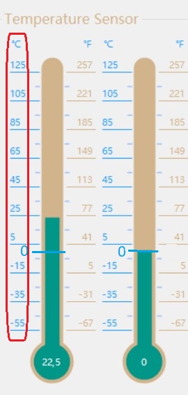

I start use KC868-COL and after connecting I look some elements what should be improved:
1) Termometers on Monitor look not so usual, temperature always need has marked 0C, bellow is negativ, above is positive, and as numerical system is DECADE, on instrument need be: 0, 10, 20, 30 ... (not 5, 15, 25, 35...) see picture

It is my sugesstion, please consider this.
thanks for your suggestion.
1. Next version we can add temperautre 0 label.
