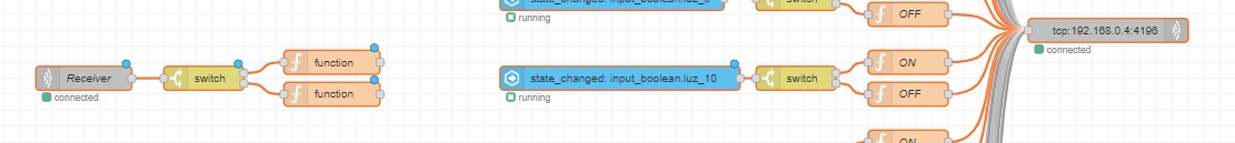

I have imported the flow to node red, changed the IP address and port of the TCP nodes.
How can I get these switches on the dashboard?
(11-14-2022, 01:41 PM)filiperod Wrote: I have imported the flow to node red, changed the IP address and port of the TCP nodes.
oh, just realized that the relays on this flow are only visible on a node red dashboard, which I have no interest in creating. I would like to keep the switches on the main HA dashboard. I can control the relays on the relay board, but can't get feedback from the board when a switch is manually operated on the expansion board.
Is there a way to connect these two ends:
