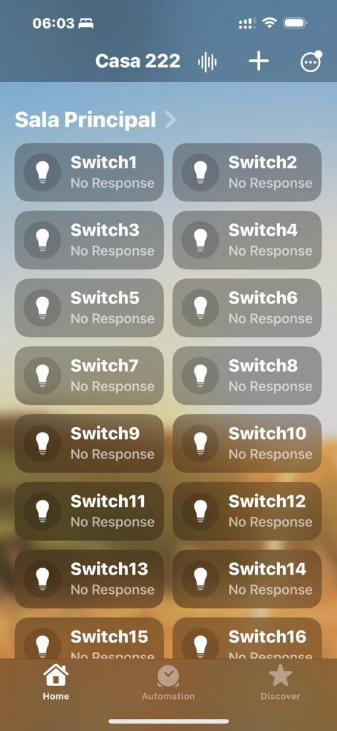

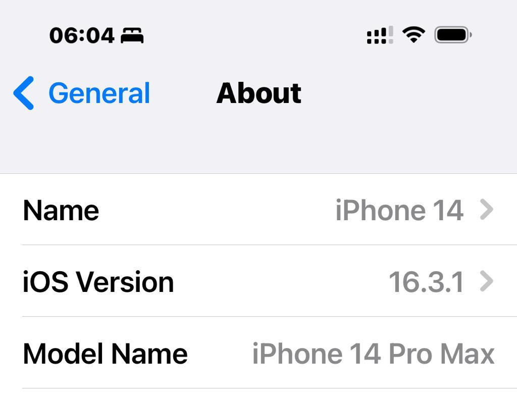

my name is Cassiano, can you please help me with my new KC868-H32B Pro ?  when connecting to app home in my iphone,    i m receiving this message - Unrecognized Controller PairingID and then shows ERROR: Device not yet paired!, ( see attached pics )
DEVICE NOT YET PAIRED -- PLEASE PAIR WITH HOMEKIT APP
* ERROR: Unrecognized Controller PairingID
* ERROR: Device not yet paired!
