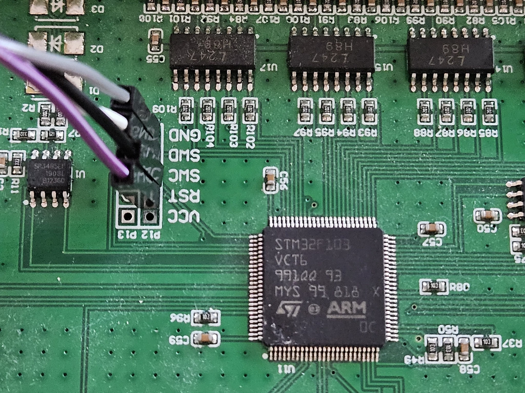

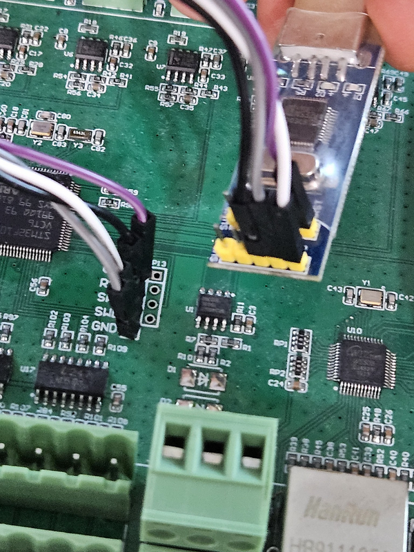

4. let KC868-D8 connect to DC12v power supply.
5. let your AT-link cable PIN connect to KC868-D8 PCB download interface.
6. press "connect" red button on PC software, then you will see it detected the chip.
7. press right window "add" button to load bootloader HEX file. (download from "https://www.kincony.com/forum/attachment.php?aid=298")
8. press "Download" button.
9. after download complete, ready to download BIN file by bootloader tool : KC868 Controller Network Bootloader.zip (download from https://www.kincony.com/forum/attachment.php?aid=297)
10. use KC868 Controller Network Bootloader to download BIN file. details step see software window step1-4
11. complete.
