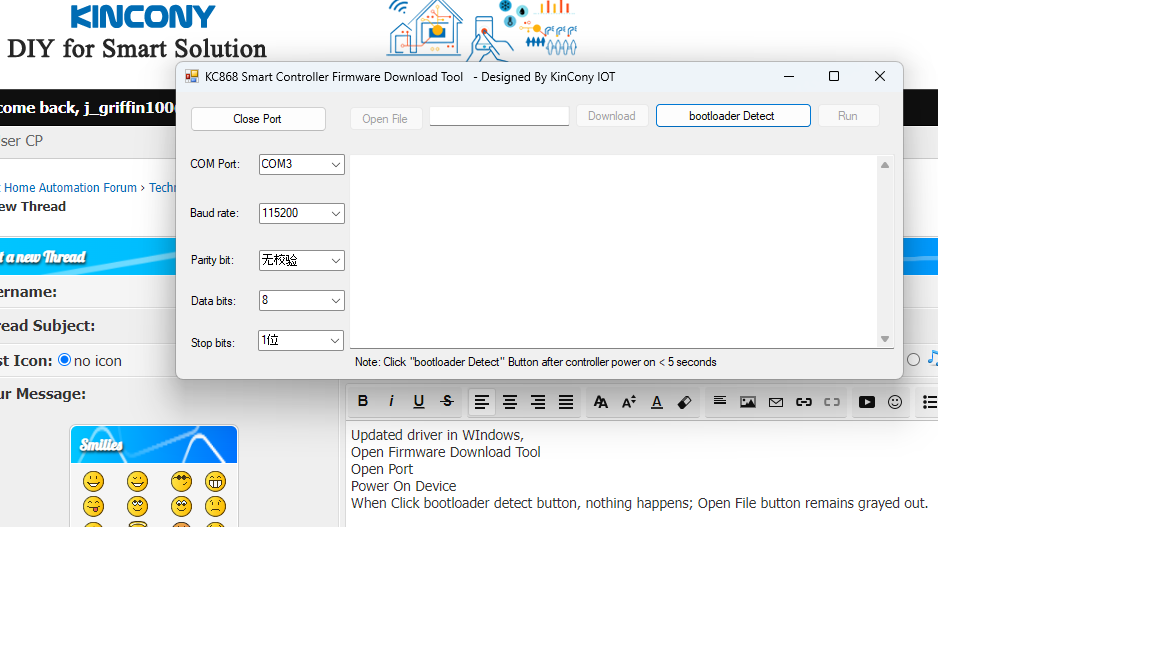

Updated driver in WIndows,
Open Firmware Download Tool
Open Port
Power On Device
When Click bootloader detect button, nothing happens; Open File button remains grayed out.
(03-13-2023, 04:34 AM)admin Wrote: when board power on , then MUST <5 seconds, click "bootload Detect" button.
Tried this. Tried also waiting >5 seconds after Power On. Still not working. After clicking "bootload Detect" button I should see "Open File" button active, correct?
(03-13-2023, 01:43 PM)admin Wrote: no no no.
power on the board, <5 second need click "bootload Detect" button. do you understand me?
here is video tour: https://youtu.be/LLIJe9VTVq8
Yes. I understand. Please see video attached. Am i doing it correctly?

Please let me know if you have any suggestions. I want to get my system back online. Currently I have lost all control of relays (app not working, remote control not working, push buttons not working).
I do not have JLink USB tool. I did try with another computer running latest version of Windows. Still did not work. Any help is appreciated. Just trying to find out why controller stopped working suddenly. Nothing changed. Only thought I had is possible electrical surge when once I tripped a circuit. I want to rule out firmware first. Can I have a suggestion to try something else? Thank you!
