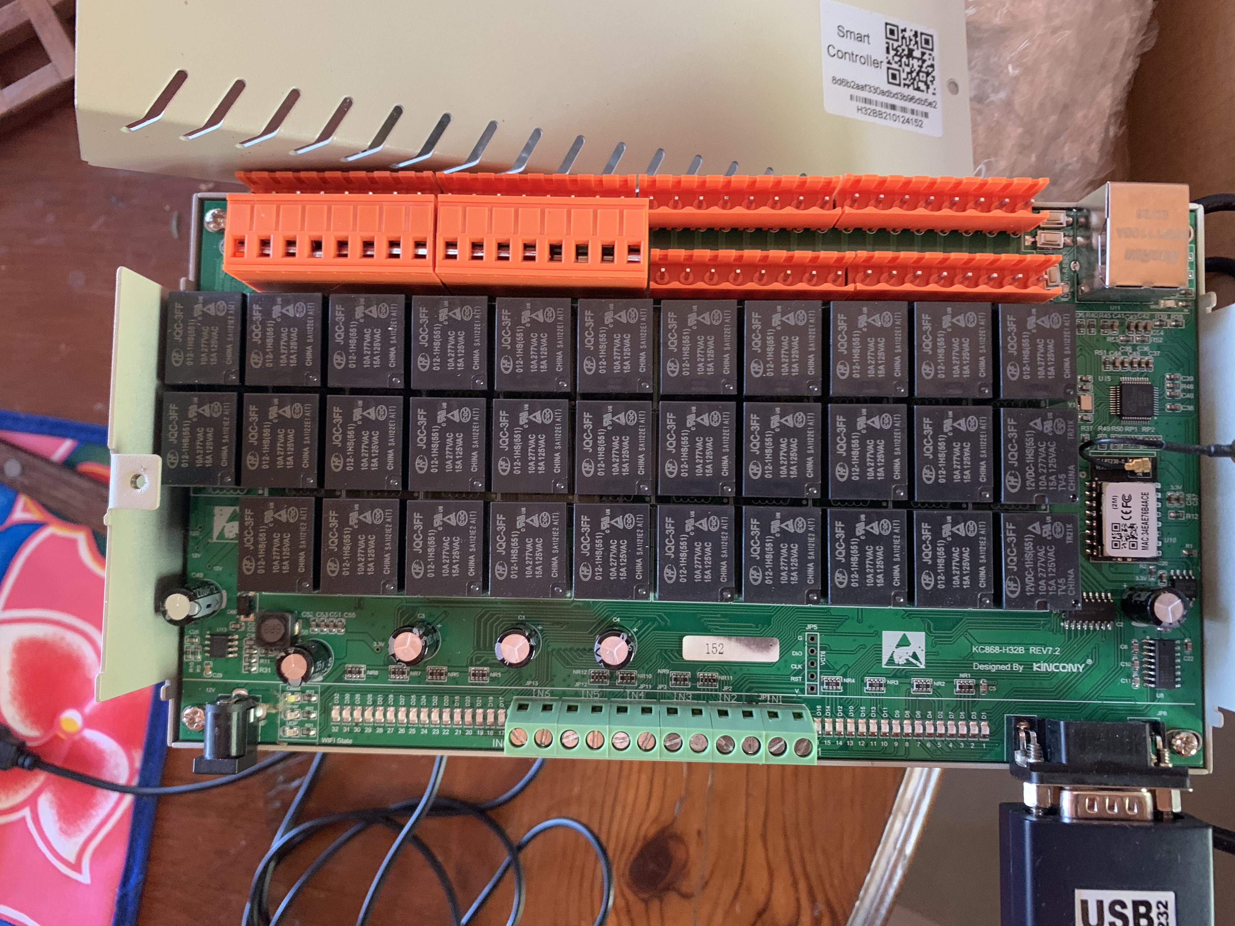

Please let me know if you have any suggestions. I want to get my system back online.  Currently I have lost all control of relays (app not working, remote control not working, push buttons not working).

maybe controller is broken, now only have the way is use JLink to download firmware. can you open your controller metal box, take a photo of whole PCB board.
(03-19-2023, 04:14 AM)admin Wrote: maybe controller is broken, now only have the way is use JLink to download firmware. can you open your controller metal box, take a photo of whole PCB board.
Thank you. Plese see attached.  Any way to test the Controller components to know if b         roken?
