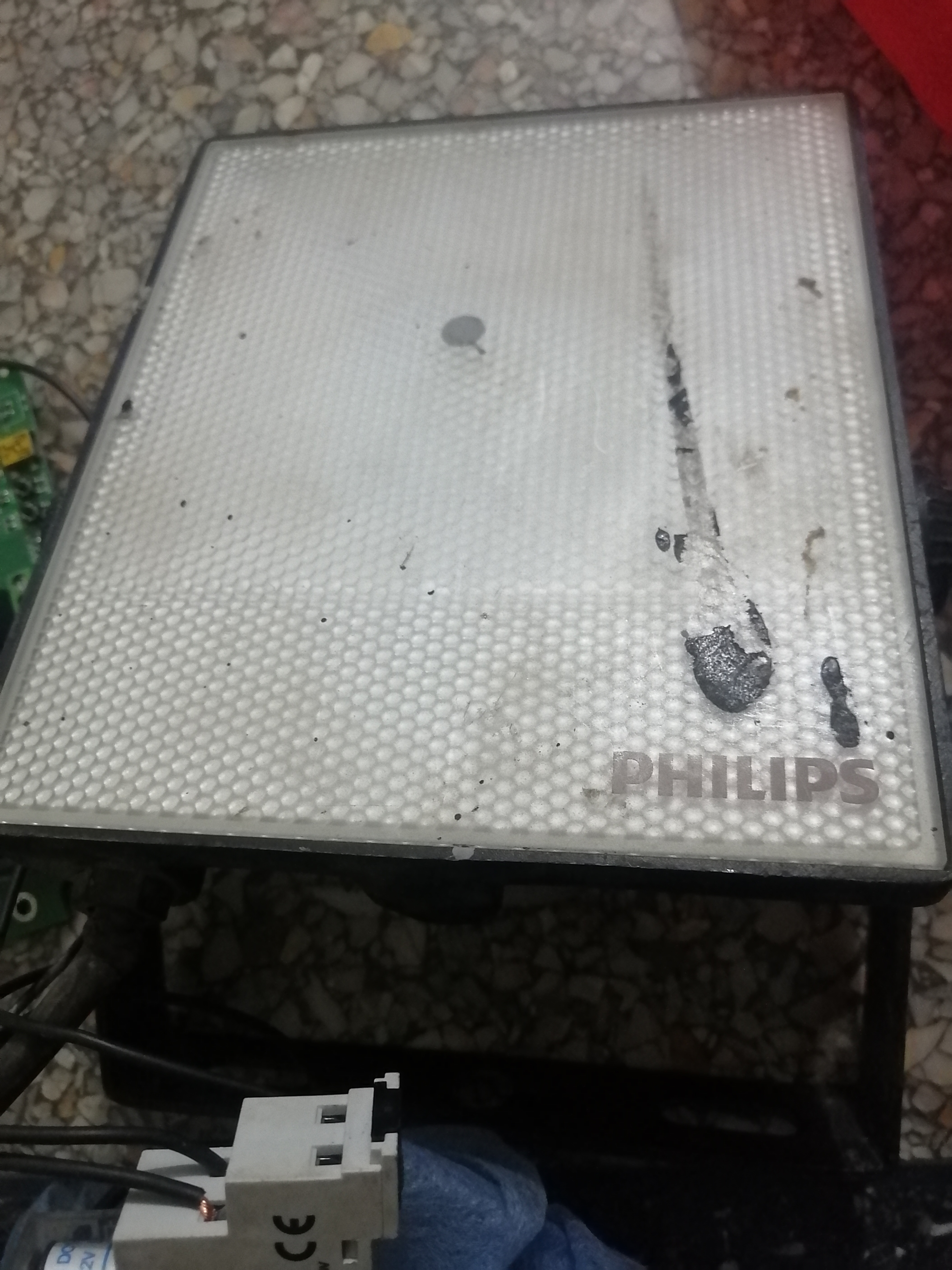

I took pictures for what im using.
I give the KC868-A4 his own power supply but no change.
we have tested , no problem with hardware. i think you can check your source code.

when i close and open the input many times, the values becomes nan.
now i removed the dc 12V relay and it works without problem.
without your test i couldn't think that the problem comes from this relay
