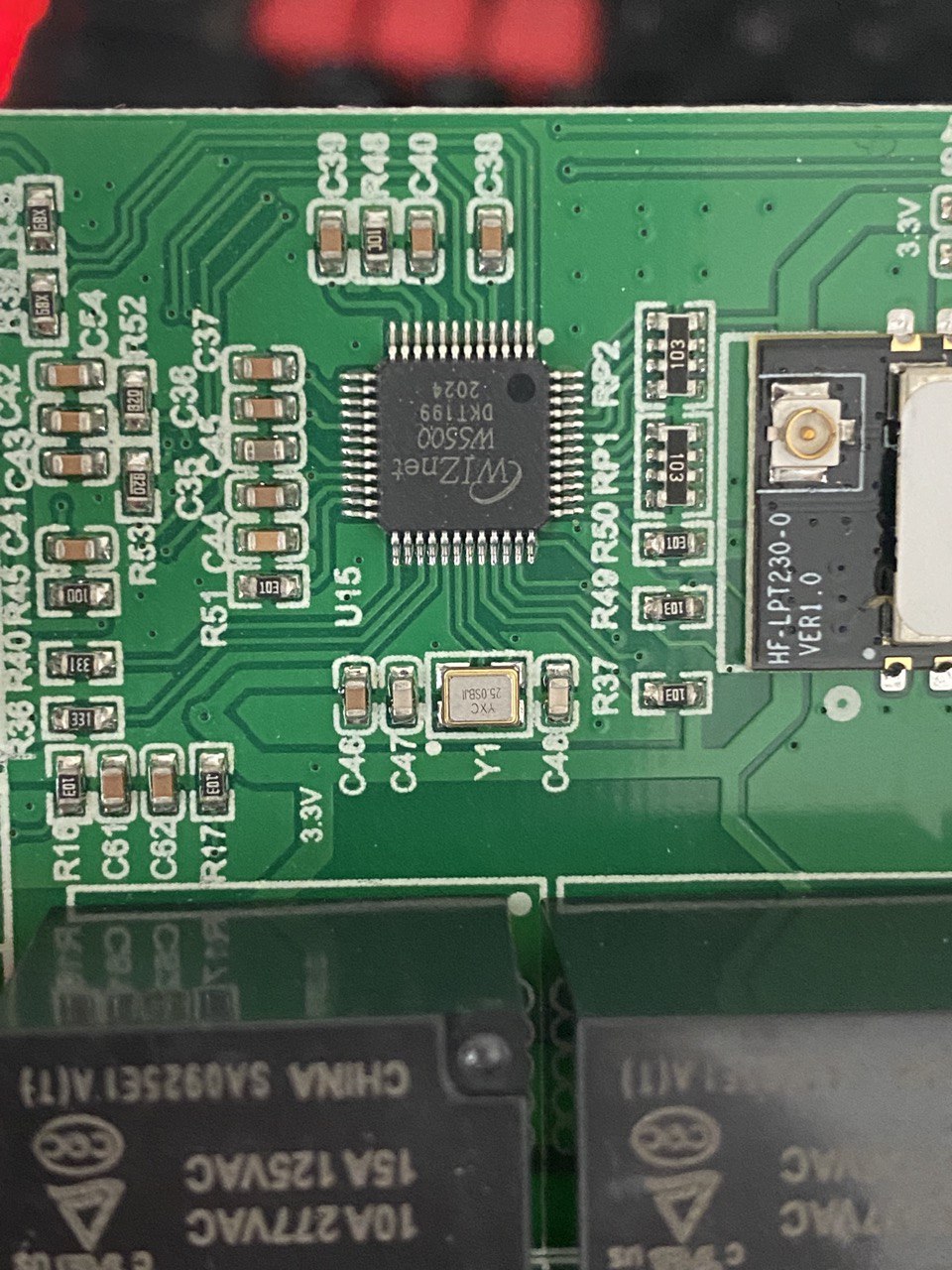

2. because begin with V4.45 , firmware size >128k, you need to update your CPU bootloader file, so that can support large new file. take a photo of your H32B pcb board, two side, i need to see your CPU chip model.

H32B need update fimrware to use KC868-AK, H32B Pro is no problem. but you should have ST-Link for update STM32 CPU.
here is st-link cable: https://www.aliexpress.us/item/225183283..._shipto=US
H32B will update firmware in furture when our development team have time. when it released, i will update to you.
