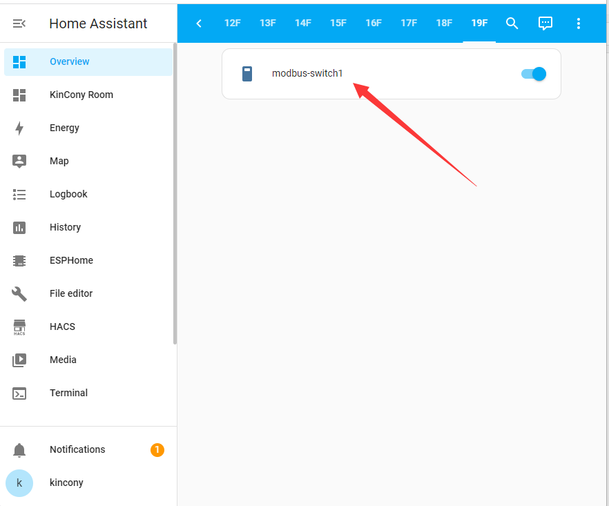

  - platform: modbus_controller
    address: 0  # 0:relay1  1:relay2 ......
    register_type: coil
    bitmask: 1
.txt   ESPHome_A16_modbus_relay.txt (Size: 6.5 KB / Downloads: 817)
this is a demo , i have created one switch button in ESPHome, you can create many others.
