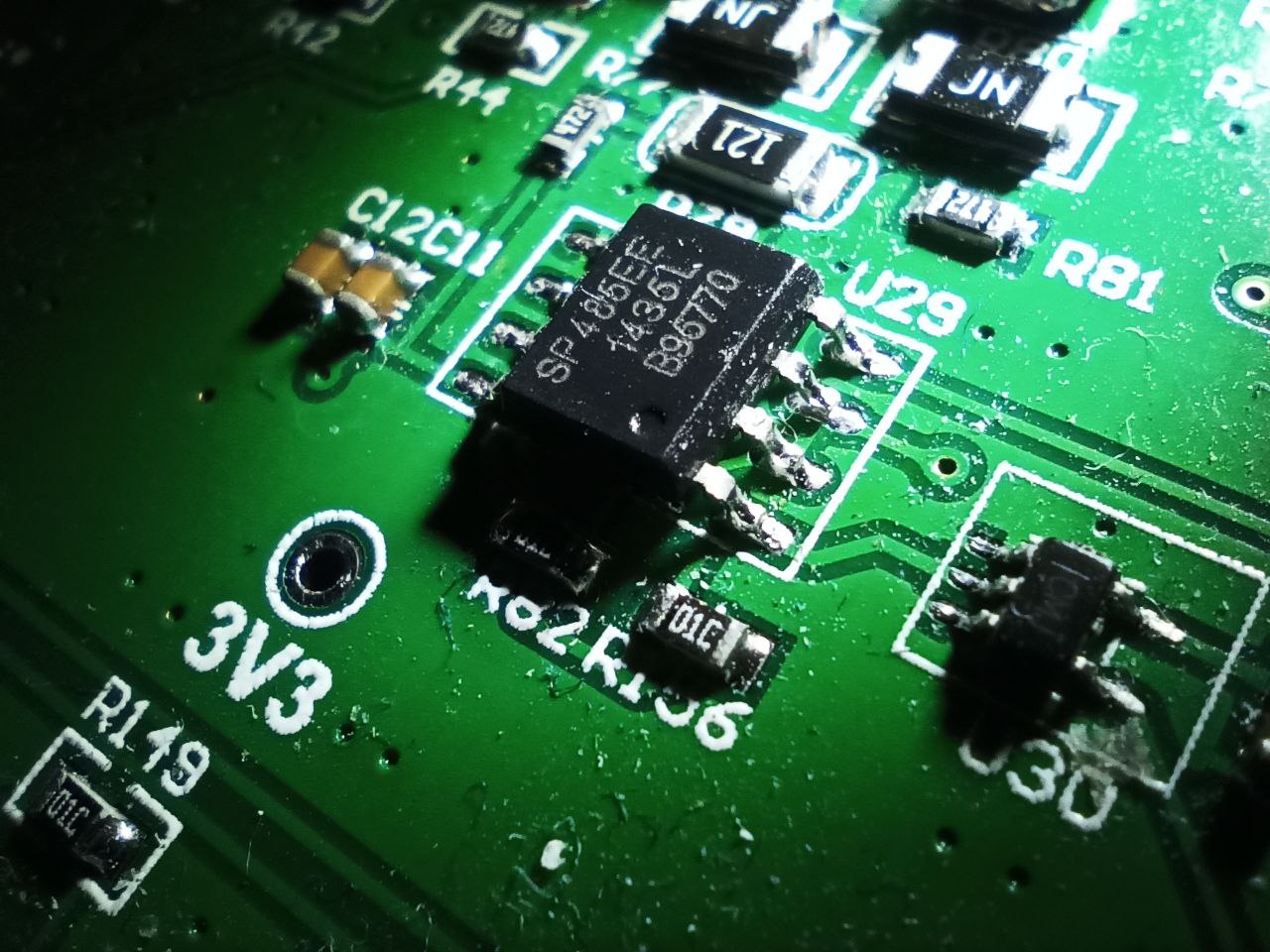

Ok, I've examined the board. I've checked the pins of the RS485 ic (marked SP485EE 1435L B95770) with an oscilloscope. I can see incoming communication on pin 6 (RS485 A), but nothing on pin 1 (receiver output). I then checked pin 2 (Receiver output enable active LOW) and it is high (5V)!
I guess this is to be expected, this is also marked in the Kincony documentation (see below). But doesn't this mean that the SP485EE output is permanently disabled???

Ok, I tested it with that firmware. The board does not echo anything back unless I pull down pin2 on the SP485EE (via 2k resistor).
Diving deeper into the datasheets, I can see that the MAX13487E that is shown on the board in the Kincony documentation has an intelligent feature to disable receiver output whenever the chip is sending. I quote from the datasheet: "Drive RE low to enable the RO. Drive RE high to let the AutoDirection circuit control the receiver."
However, my rev1.4 board does not have a MAX13487E but rather an SP485EE, which does not have an AutoDirection circuit according to its datasheet, and the RE has to be driven manually, which is not implemented on this board!
Did I buy a counterfeit Kincony board???

For anyone having the same problem: it was possible to read messages by putting a 2k resistor between pins 2 and 5 of the onboard SP485EE (i.e. a pulldown on the receive enable pin), but then the receive circuit of the SP485EE is always active, which means that the ESP32 also receives the bytes that it sends itself (a sort of local echo). That may be acceptable when you write your own firmware, but ESPhome - for instance - can't handle this. (Not out of the box, anyway.)
The real solution:
KinCony immediately sent me two MAX13487 ICs. I've put one on the board, replacing the SP485EE, and now I can send AND receive messages (without the local echo). I am happy that, once the problem was identified, KinCony offered a solution right away. Thanks! :-)
That being said, the conspicuous silence I received when asked how the wrong chip ended up on the board in the first place does not fill me with confidence about production and/or quality control; I am left wondering how many boards are out there with the same problem, and how many people are spending hours figuring out "why it doesn't work"...
