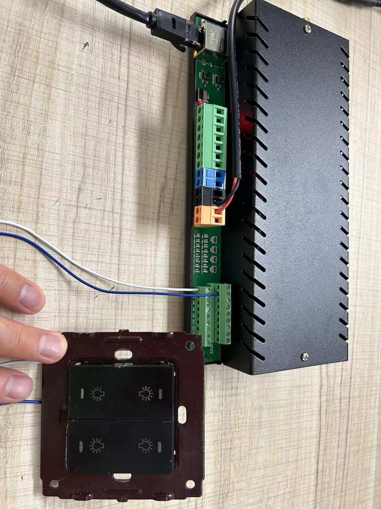

this is 3 mode for KC868-A16S controller set by ESPHome:
1-click: toggle relay1
2-click: toggle relay2
3-click: toggle relay3
actually you can add 4-click, 5-click, 6-click, ........
tested with KC868-A16S
