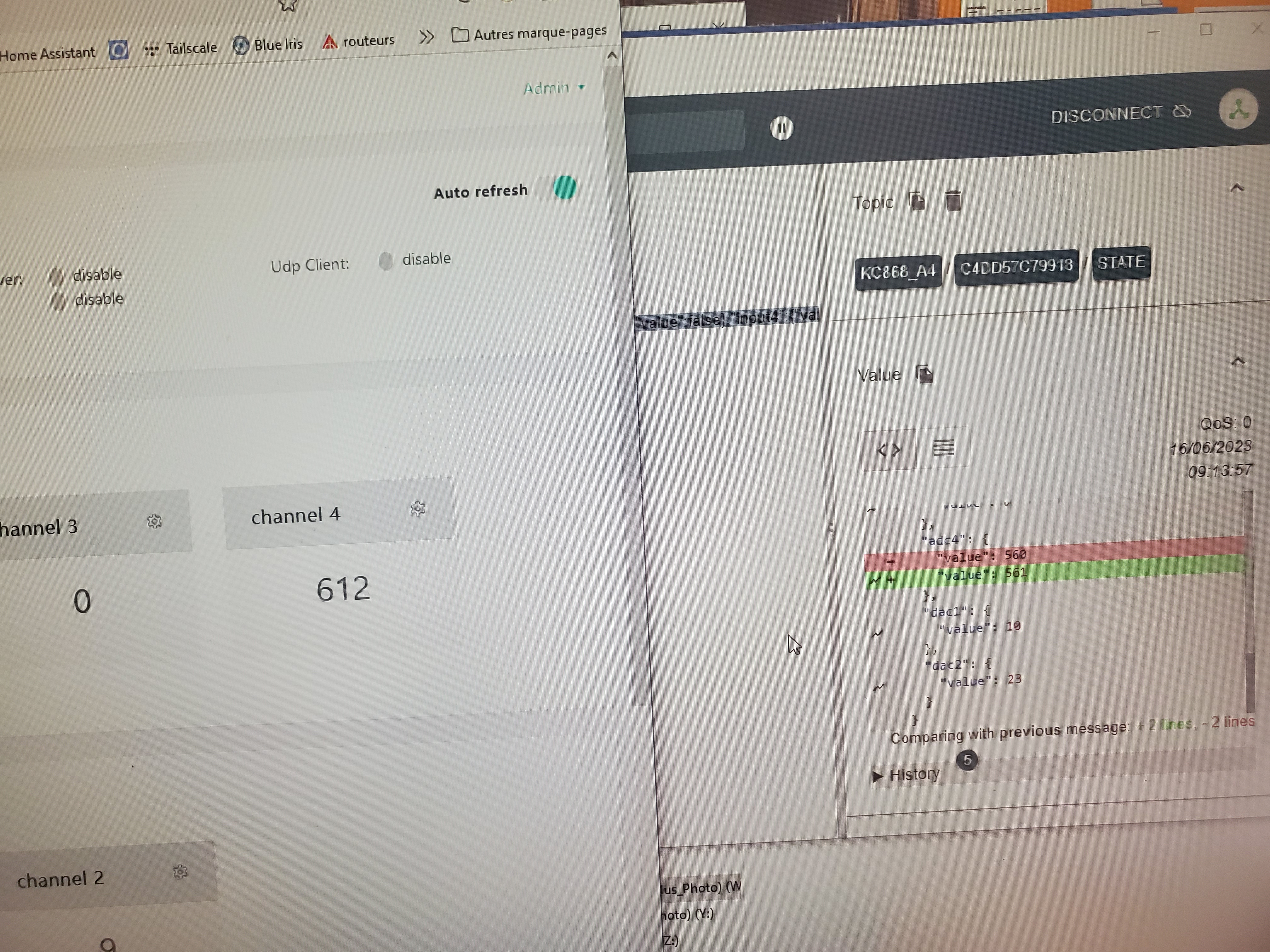

Let me rephrase my problem. Yes in one Mqtt frame , I get everything updated ( relay,input,analogic...). The problem is that this frame is only sent when a relay or digital input changes.
If only an analogic input changes, there is no mqtt frame being sent. This is what one of my pictures shows.

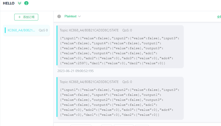

Reply: I Was test the problem,KC868-A4 power on and do nothing,just set the value of Analog4 when the value up to 2000,it will send mqtt command,no relay control no input trigger,when analog 4 is connect to 3V,it will send the value about 2596 .See the picture below.

Sorry, there is no mqtt update on my side. See my video.I increase the sensor temperature. KCS reflects this increase, bt there is no mqtt frame being sent to mqtt explorer. https://drive.google.com/file/d/1wZtfjjR...sp=sharing
