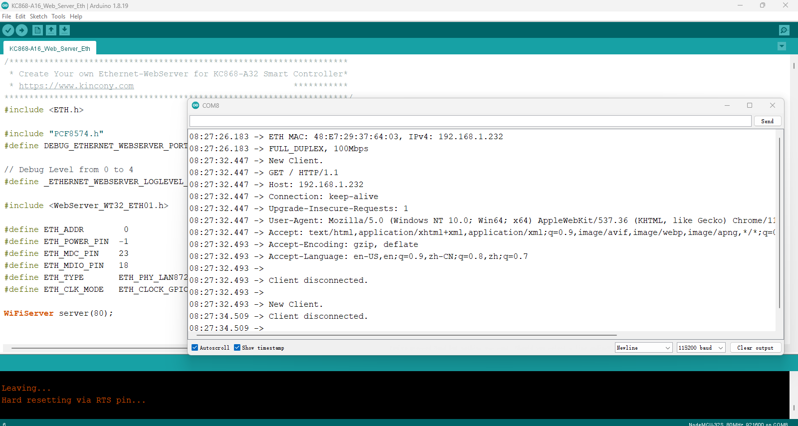

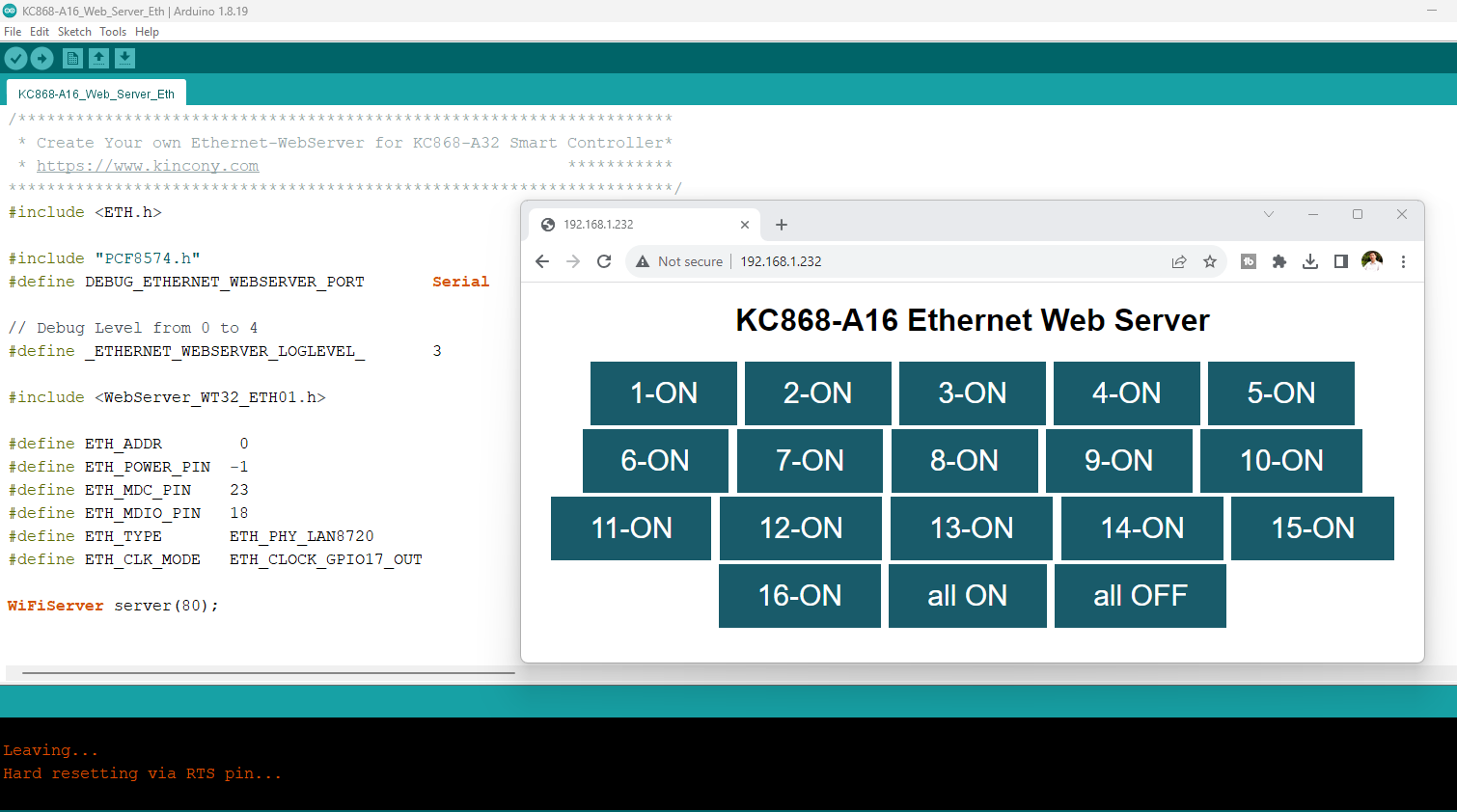

you can download our KCS v2 firmware, check ethernet whether work well firstly.
https://www.kincony.com/esp32-kcsv2-firmware.html
use this newest code, it will be work fine, just need add ETH.h library and some ethernet setting code. here is updated , you can directly to use:

here is arduino source code you can download:
.zip   KC868-A16_Web_Server_Eth.zip (Size: 6.2 KB / Downloads: 1,011)
Ok Thanks. this has worked.

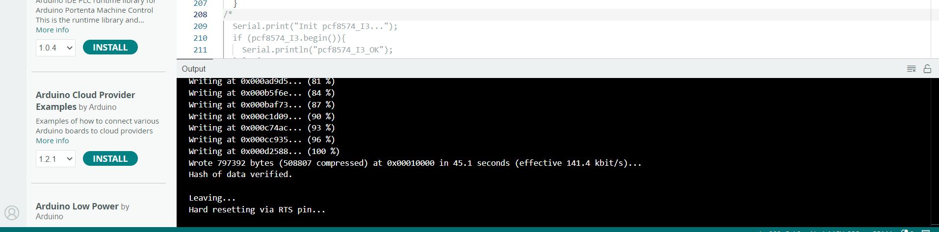

How long does the reset take? I've been waiting for 20 minutes, nothing changes, just "Leaving...
Hard resetting via RTS pin..."
