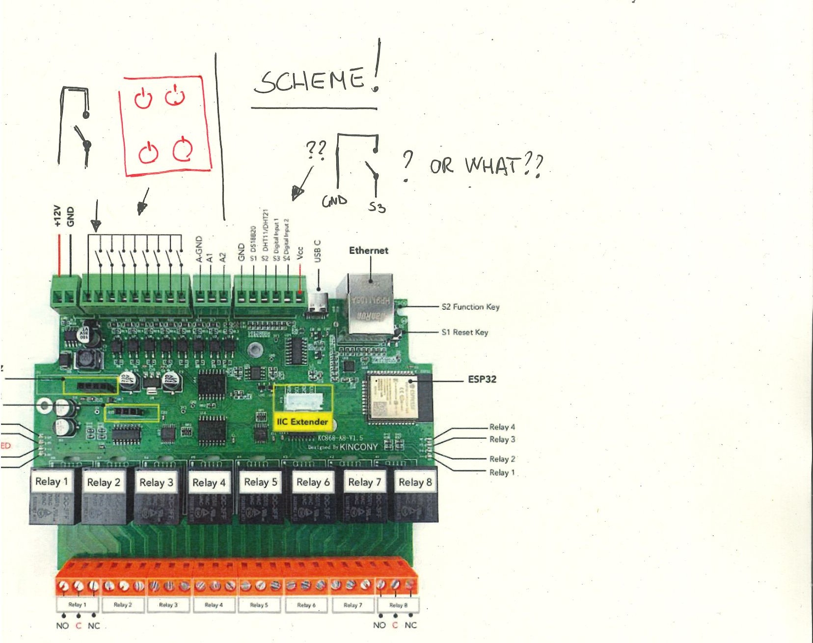

can you send me the connection/wiring scheme?
[Image: attachment.php?aid=2917]
(09-18-2023, 12:43 PM)admin Wrote: [Image: attachment.php?aid=2917]
Maybe I did not say it clear enough. I ask for a scheme to use s3 and s4 inputs like d1, d2 etc.
S3,S4 use way as same as D1--D8, just D1--D8 support long distance 300meter. S3,S4 use by short wire way.
Excuse me. I asked for a connection diagram to use the digital inputs as dry contat.
right, just S3 or S4 connect a switch for GND.
