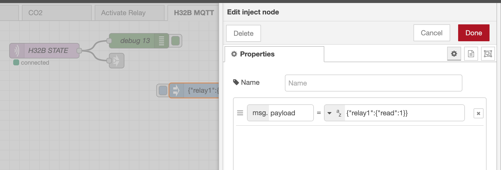

How to read the state of value for H32B?
09-22-2023, 07:50 AM
(09-22-2023, 07:50 AM)admin Wrote: https://www.kincony.com/download/KC868-H...ommand.pdf Later i'll try Do you have reference for TCP? i want to try too. want to see which one is better. (09-22-2023, 07:50 AM)admin Wrote: https://www.kincony.com/download/KC868-H...ommand.pdf Nothing happens in debug. No reading state. Any my mistake & take a look. https://drive.google.com/file/d/1L9LoYEK...sp=sharing

every relay state or INPUT port state is changed, will auo feedback all INPUT and OUTPUT state by mqtt. not need to send query command. no query command.

mqtt will auto receive feedback message.
if you want to use TCP, here is TCP protocol: https://www.kincony.com/smart-controller...tocol.html we suggest to use mqtt is better.

(09-23-2023, 05:25 AM)admin Wrote: mqtt will auto receive feedback message. OKAY THANKS... |
