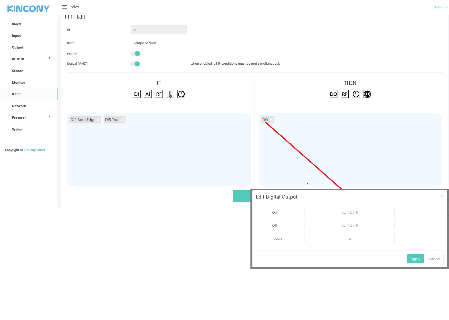

I'm trying the version 2.1.9 and i canot able to make it work with IFTTT "AND" fonction! I want to set on output 2 (in Jogging mode) when input 5 is "True" and input 2 is "Both Edge".
When we set DI2 in "both Edge" the output do not work...

can you take a screen photo how to set, we can test as your setting.
we will save your suggestion.

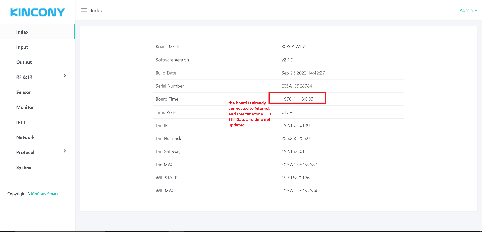

Good day everyone, How can i change the BOARD TIME?  im using the KC868-A16S v2.1.9... The board time is 1970-1-1 8:36:41, i want to update the date and time.
Thank you..
connect board with internet, board time will auto update from internet. just you need to set the time zone.
(11-11-2023, 08:32 AM)admin Wrote: connect board with internet, board time will auto update from internet. just you need to set the time zone.
the board is already connected to my router LAN and WIFI with internet. but still date and time not updated.
is there other settings i need to change ? network ?

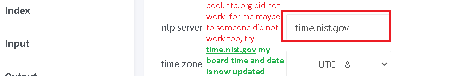

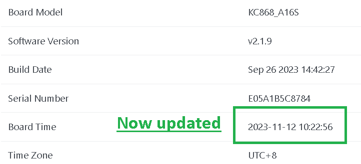

It did not work for me, but i want to share to everyone or to someone who has same board time problem, use time.nist.gov. see pictures.
Thank you admin.
