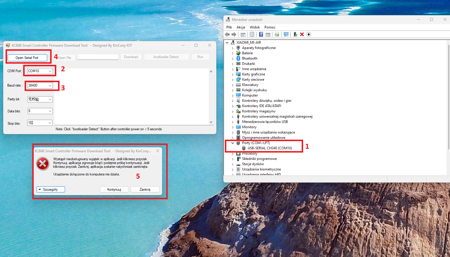

Hi,
Computer is detecting serial port, but in HA485 config tool serial port is not detected.
1: insert usb-rs485 adapter
2: open software

(10-02-2023, 08:16 AM)admin Wrote: 1: insert usb-rs485 adapter
2: open software
I did like in this tutortial. All the time I get an error.
(11-02-2023, 02:00 PM)Sewek0 Wrote:

Hi, Nick
I start up software with admin privages.
Than disconnect USB to rs485
Wait 5 sec and connect again After that I got again this message
I am using Windows 11 but I do not thing that this is important.
But if a do it with USB to TTL (CH340) or (CP2101) ther is no errors but I can not open bootloader.
can you try with another USB port, or another computer? whether have another problem used COM10?
