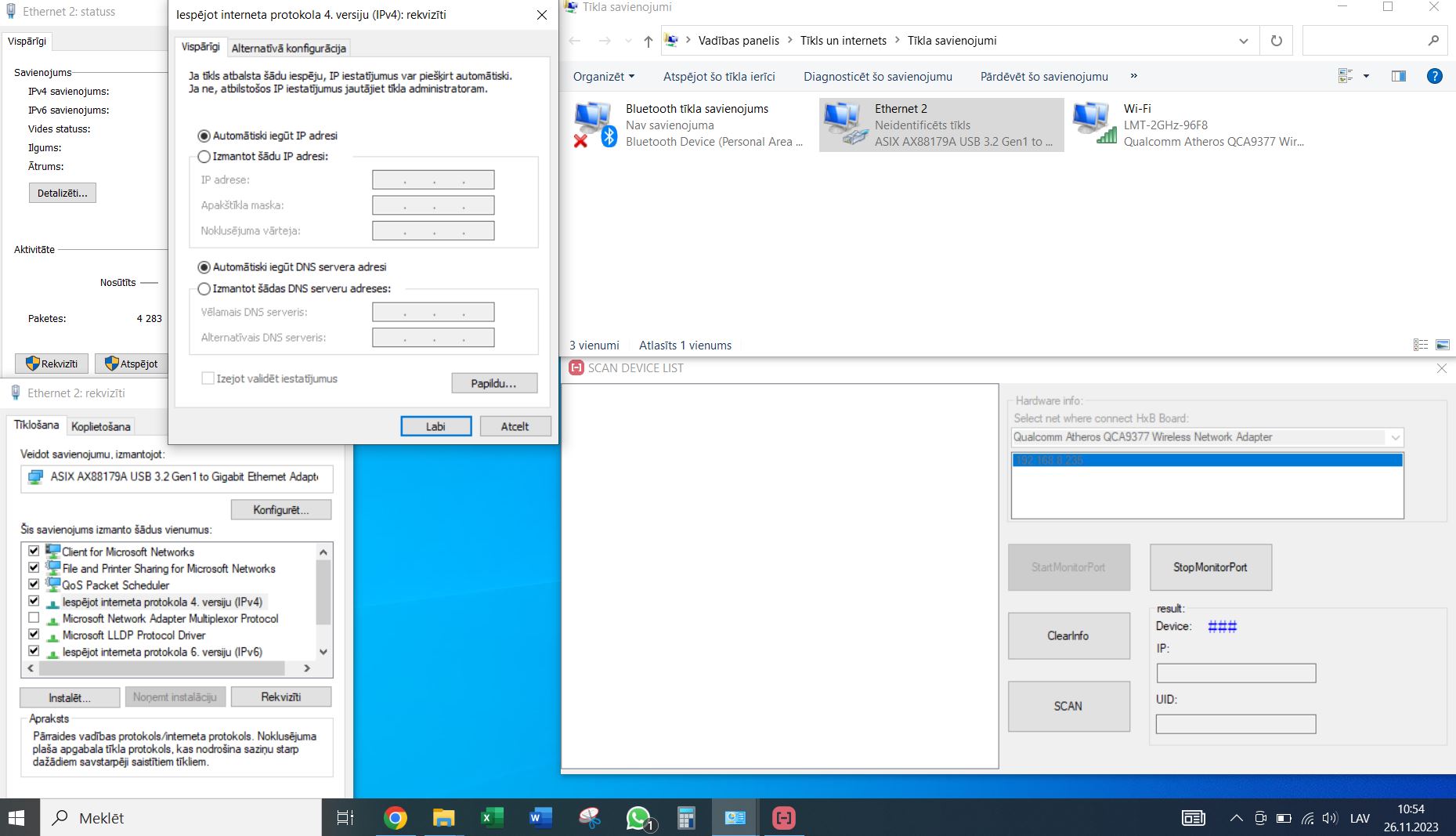

Because the Lan wire is not identified. I think if I put another sketch, the lan wire will be identified. I started from the beginning. I loaded only the KCS_KC868_A16_V2.1.9.bin file according to the instructions. There is a wifi network. Lan cable shows as "Unidentified Network".
I also changed the IP address in the Lan properties to: 192.168.1.200
255.255.255.0 but no change.

do you let A16 connect to your router by network cable? or you use network cable connect A16 with your computer directly?
#24
(11-26-2023, 11:21 AM)admin Wrote: do you let A16 connect to your router by network cable? or you use network cable connect A16 with your computer directly?
The laptop is connected to the board with a usb to lan adapter.
#25
no, you should let your A16 and computer connect to same router.
#26
(11-27-2023, 10:45 AM)admin Wrote: no, you should let your A16 and computer connect to same router.
The connection to the Lan wire was successful through the router. Thank you.
