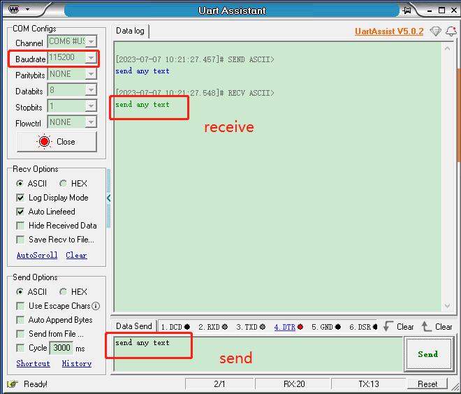

I want to use serial to show income data but no luck. Serial is empty. Do I need to add code to print in computer serial?
set like this:

our demo code can't work well?
(11-28-2023, 10:08 AM)admin Wrote: our demo code can't work well?
Thx for Your fast reply,
No I tried to connect the KC868-A8M to a sensor, to read data via RS485 and  I didn't get any result using the demo code
you need modify code according to your sensor's protocol.
