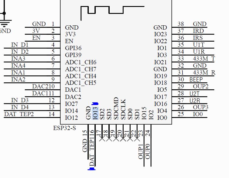

I have a KC868 A4 board and for some reason the relay 02 stopped working, in some measurements I verified that there is no voltage coming out of the esp32 (output burned) do you have any reserve IO ratio?

02-16-2022, 03:10 AM
this is KC868-A4's pin define, i think you can use DS18B20 GPIO13 for relay.
#define DAC1 25 #define DAC2 26 #define ANALOG_A3 32 #define ANALOG_A4 33 #define ANALOG_A1 34 #define ANALOG_A2 35 const int Relay1 = 2; const int Relay2 = 15; const int Relay3 = 5; const int Relay4 = 4; const int DI1 = 36; const int DI2 = 39; const int DI3 = 27; const int DI4 = 14; const int BEEP = 18; DS18B20 ds(13);

I input looking at the drawing and the same is used for "Date TEMP"? only have this IO reserve?

DAT_TEMP can use for DS18B20 or DHT11/DHT22 temperature sensor, you can also use for relay, just this pin will have a pull-up resistance, if you don't want it, you can solder and remove it.
