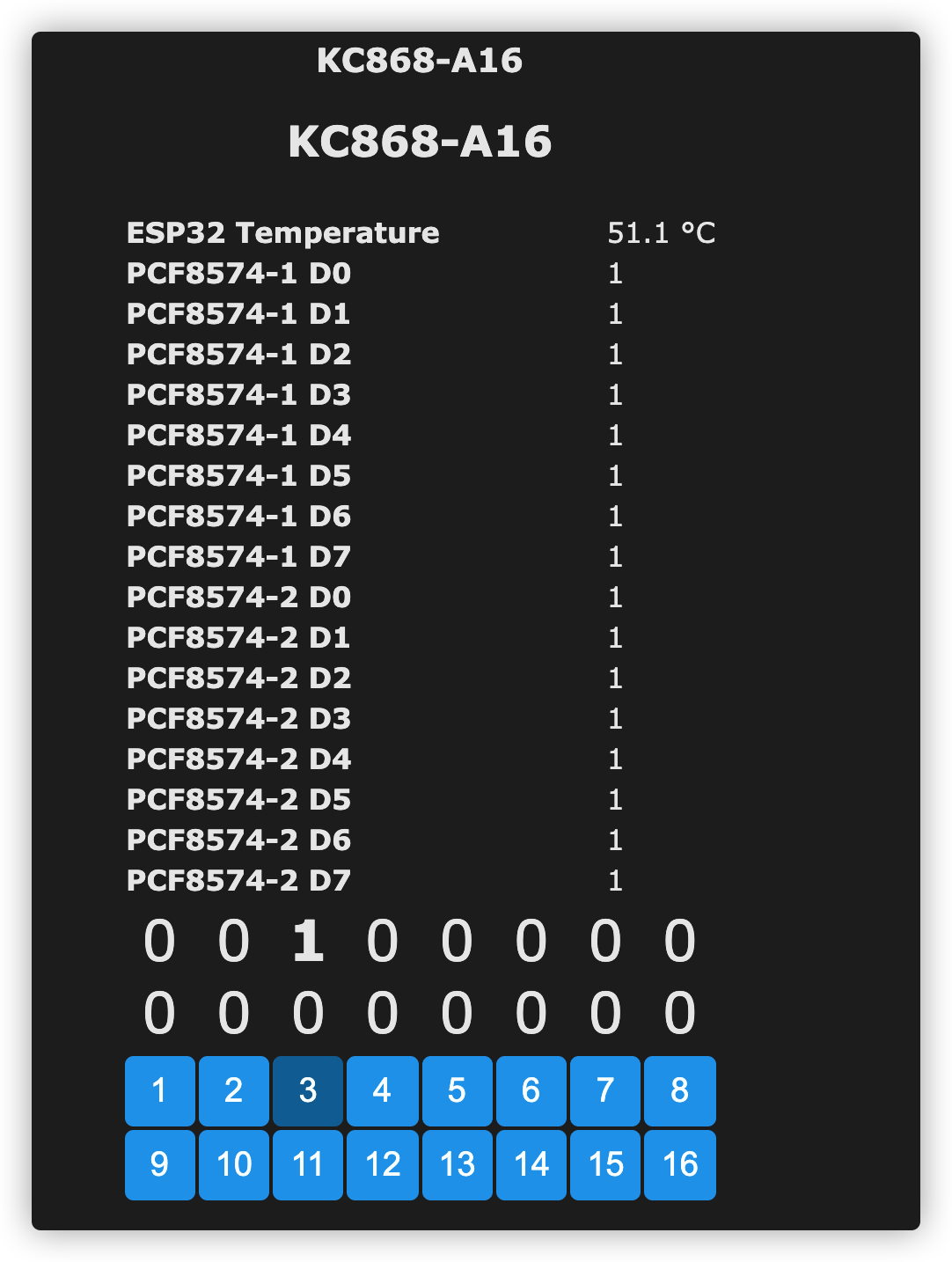

How to use tasmota for KC868-A16 via PCF8574 IIC extend GPIO
these are tasmota firmware BIN file for KC868-A16.
after you download, you need config wifi ssid and password by board's AP.
1. download tasmota download tool for KC868-A16
.zip   ESP-Flasher-Windows-x64.zip (Size: 16.07 MB / Downloads: 2,620)
2. download tasmota BIN file firmware for KC868-A16
.zip   firmware-en-a16.zip (Size: 762.33 KB / Downloads: 3,098)
PCF8574 GPIO config for 16 channal output and 16 channel input

thanks for the firmware, already try and can run well
Hi there....
Can we please get the changes you made to the source code so we can compile later versions.....? Do the changes support ethernet ?
Thankyou..Peter
you can use our firmware directly, it already support ethernet.
(05-13-2022, 02:18 PM)admin Wrote: you can use our firmware directly, it already support ethernet.
Sorry that was NOT my question.  Can you please supply the changes you made to the userconfig file in the tasmota source code so I can compile my own software....
Thankyou
here is source code of tasmota: https://github.com/arendst/Tasmota
we only enabled PCF8574 in config.
(05-15-2022, 12:04 AM)admin Wrote: here is source code of tasmota: https://github.com/arendst/Tasmota
Hi Kincony
Thankyou....I wasnt sure if you had to do more.  I found the ethernet enabled in ESP32 and enabled the PCF8574 in tasmota....AS my board hasnt arrived so I cant test.
Appreciate your fast response :-)
Peter
yes, i think when you have a board, debug it will be better, just enable or disable comments on source code config.
Hi @admin
I have flashed attached firmware and performed configuration described above.
On the first start I have connected it to my Access Point(set my wifi/password to connect).
Now I would like to connect the board via ethernet, but can't configure it.
Do you have any recommendation on how I can set Eth configuration?
Thank you.
wifi and ethernet can't work at the same time, disable your wifi, just use ethernet.
