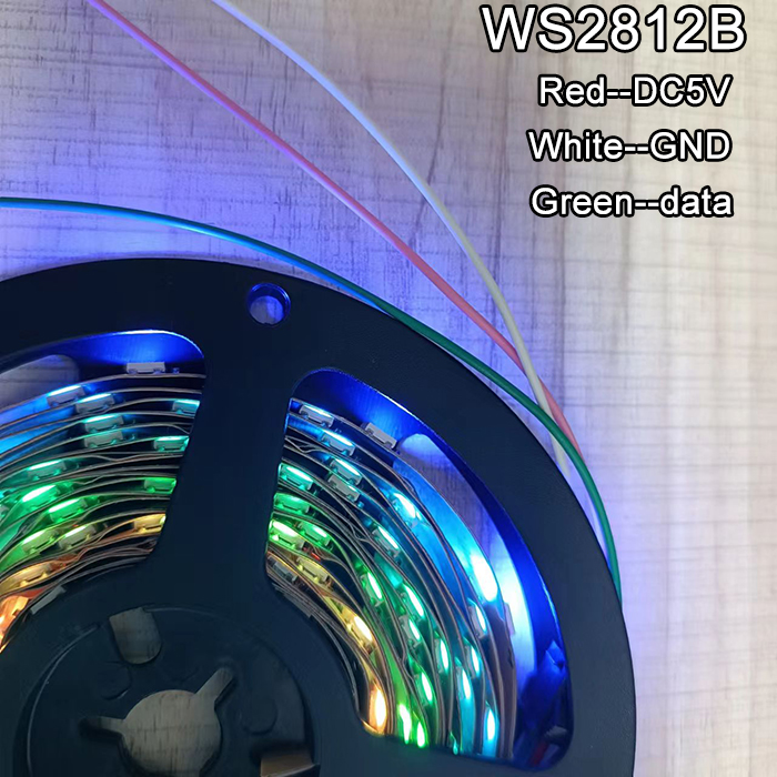

#include <Adafruit_NeoPixel.h>
Adafruit_NeoPixel rgb_display_4 = Adafruit_NeoPixel(5,4,NEO_GRB + NEO_KHZ800);
// LED numbers is 5    led connect to IO4
void setup(){
  rgb_display_4.begin();
void loop(){
  rgb_display_4.setPixelColor((1)-1, (0xff0000)); //LED 1 RED
  rgb_display_4.setPixelColor((2)-1, (0x3333ff)); //LED 2 BLUE
  rgb_display_4.setPixelColor((3)-1, (0xffff33)); //LED 3 YELLOW
  rgb_display_4.setPixelColor((4)-1, (0x33ff33)); //LED 4 GREEN
  rgb_display_4.setPixelColor((5)-1, (0xcc33cc)); //LED 5 PURPLE
  rgb_display_4.show();
Install "Adafruit_NeoPixel"first
