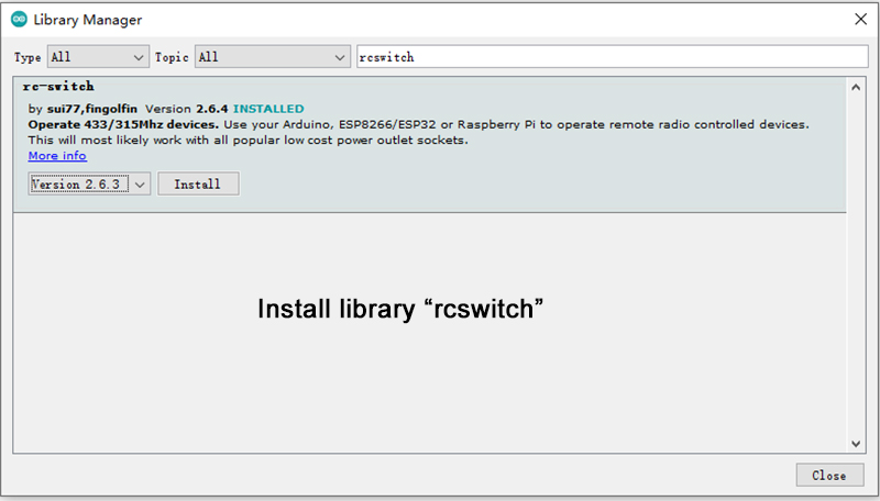

[Arduino IDE demo source code for KC868-E16S]--#01-KC868-E16S-433-decode
Thumbs Up
/*www.kinocny.com */
/*KC868-E16S CODE OF 433MHz decode*/
#include <RCSwitch.h>
void setup() {
  Serial.begin(9600);
  mySwitch.enableReceive(digitalPinToInterrupt(4));
void loop() {
  if (mySwitch.available()) {
    Serial.print("Received ");
    Serial.print(" / ");
    Serial.print("bit ");
    Serial.print("Protocol: ");
    mySwitch.resetAvailable();
.zip   KC868-E16S-433-decode.zip (Size: 669 bytes / Downloads: 845)
