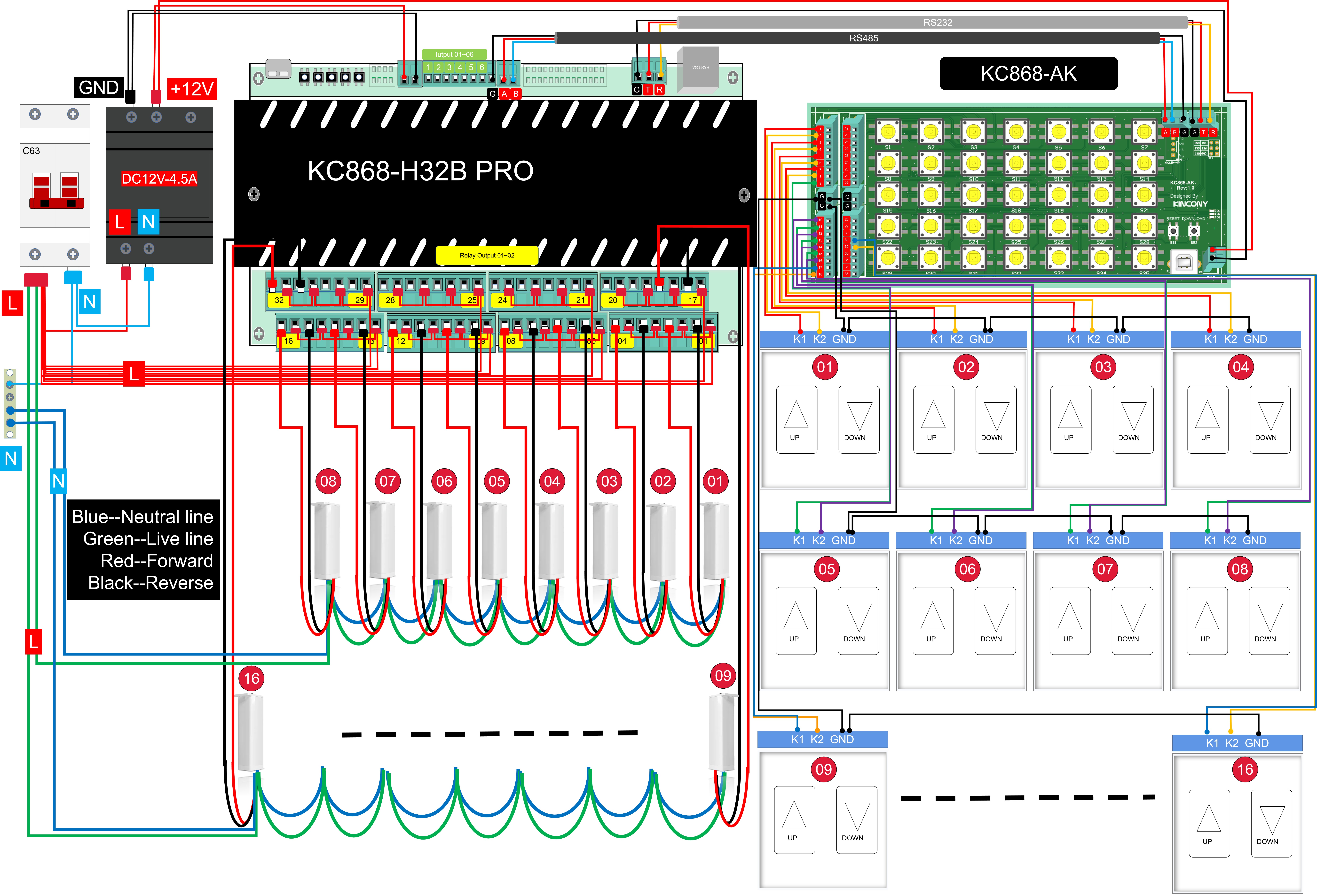

Here is KC868-H32B Pro smart controller work with curtain motor and KC868-AK for manual control switch panel. You can enable KC868-H32B Pro "interlock" function for motor protect, so that will not let two relay ALL ON simultaneously.

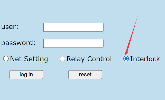

How exactly can such protection be enabled?
update your H32B Pro firmware to newest, then will have a "interlock" option in setting.
