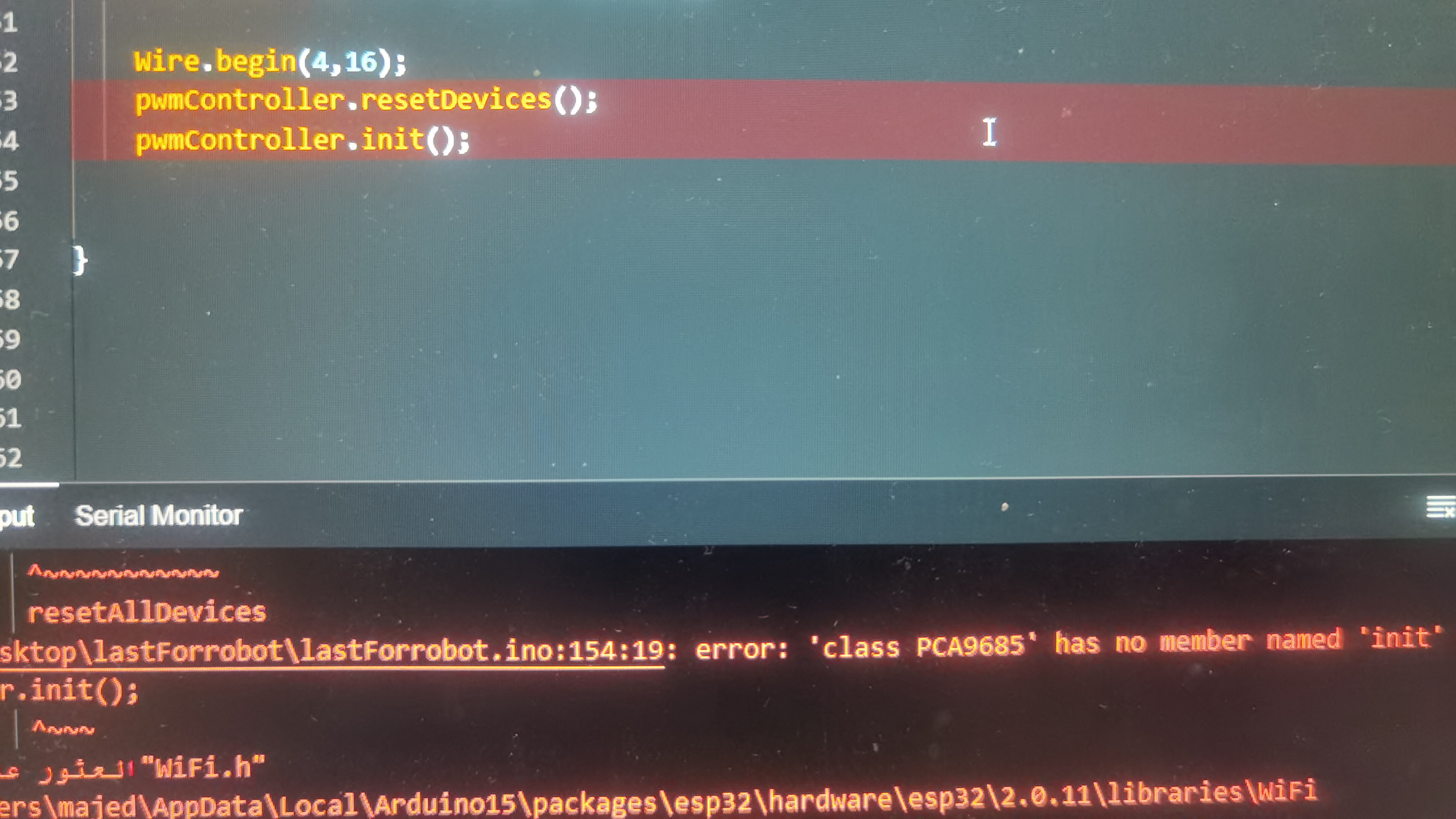

Hello dear.. I tried to apply this lesson, but unfortunately this error appears.. The same library was used
you can use this arduino library:
.zip   PCA9685_16-Channel_PWM_Driver_Module_Library.zip (Size: 349.64 KB / Downloads: 814)
