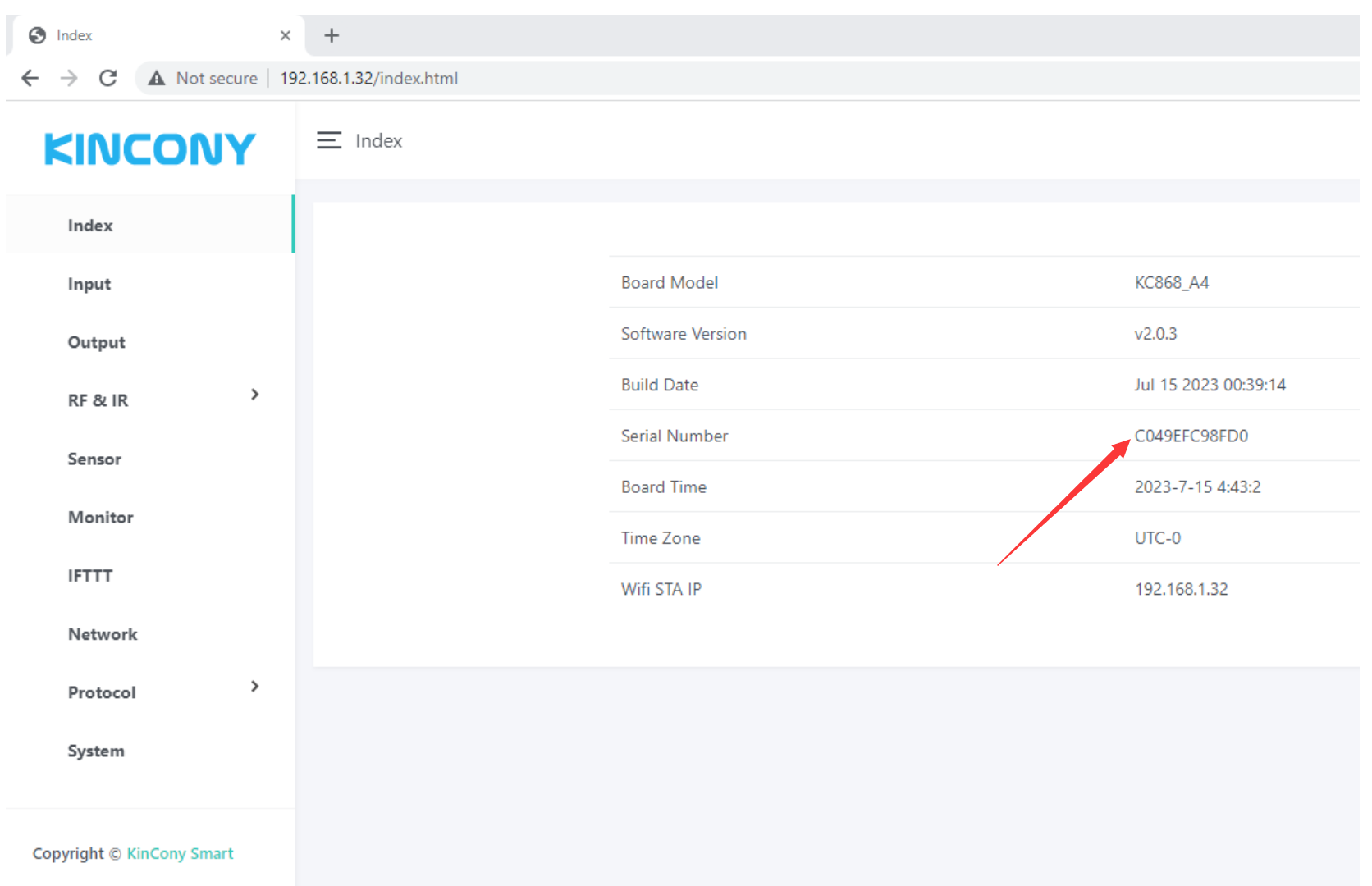

Good day sir, what is the UID for KC868-A16S?
i want to use mqtt but i do not know where to find my A16S UID. Can you give mqtt example code? thank you.
everboard will have a UID. you can check on config webpage, there is serial number.

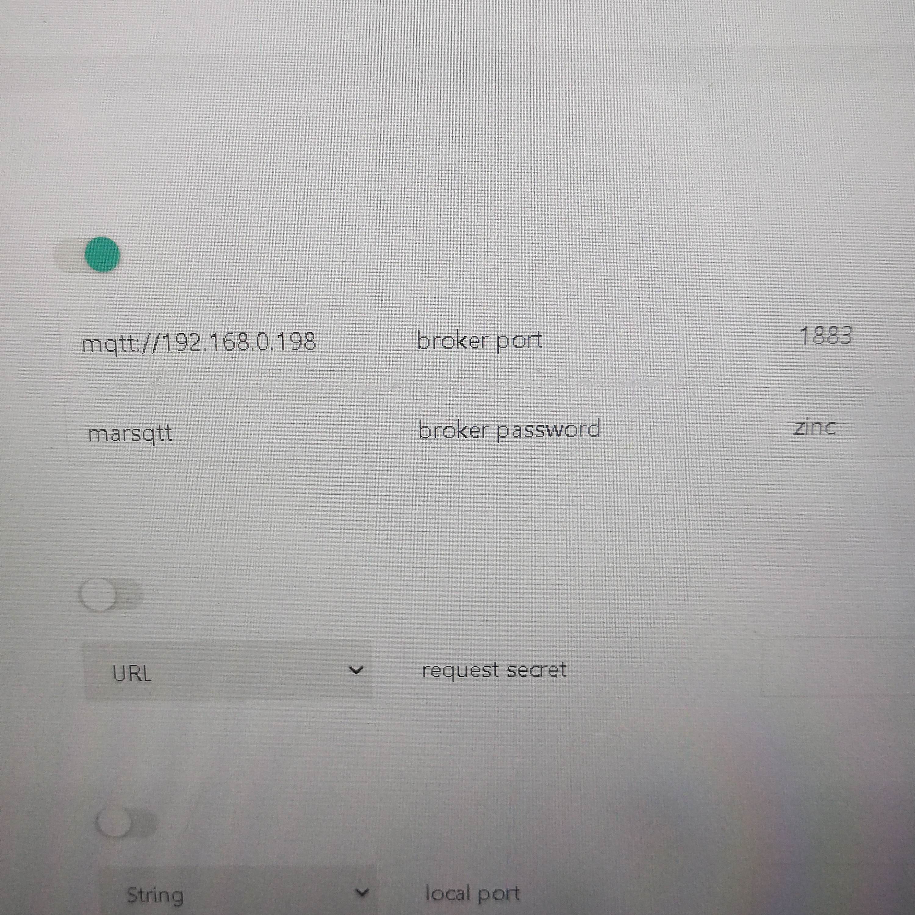

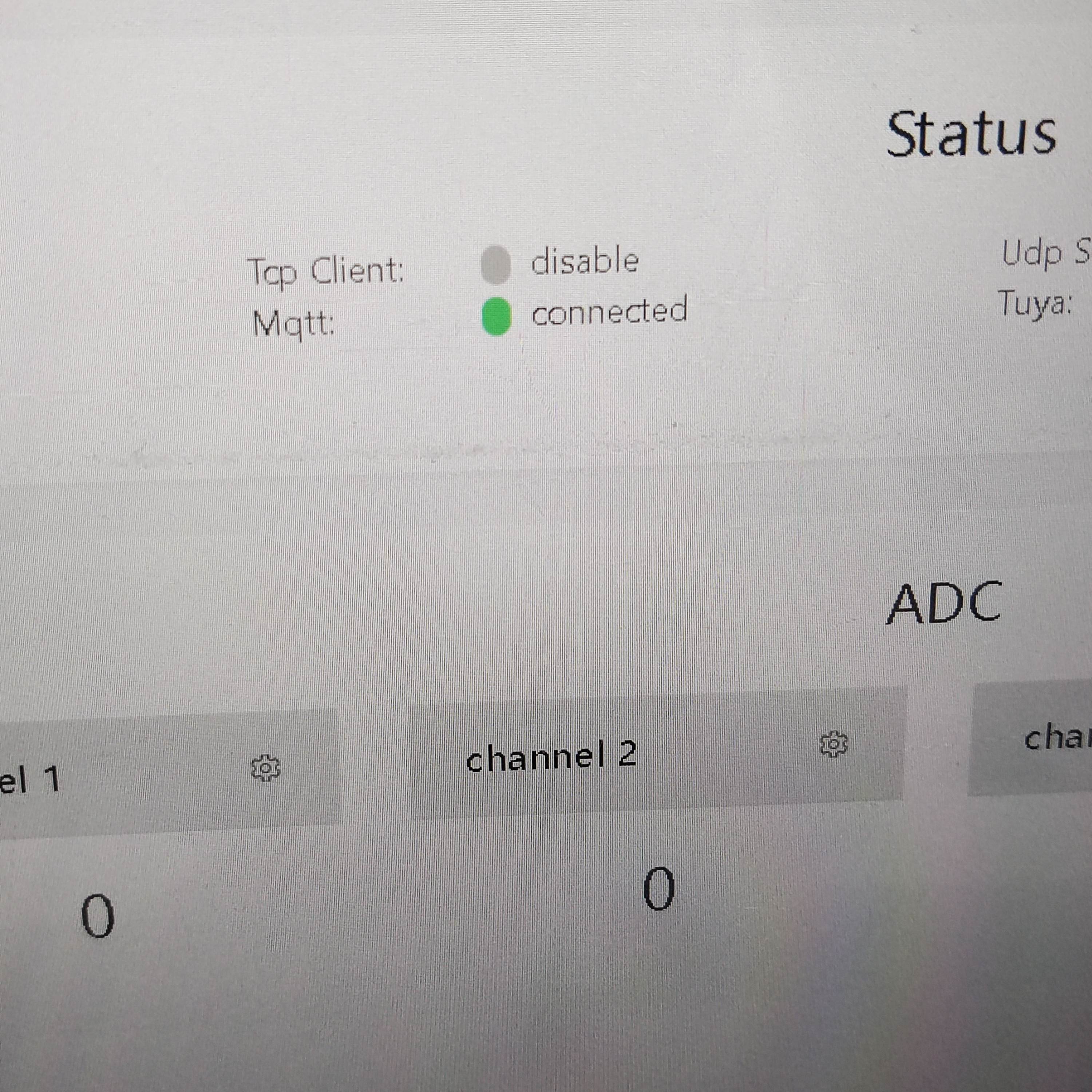

sir i changed the uid to my board serial number, but homeassistant and the kc868 a16 board not communicating. please check what is problem with code . i am using KC868-A26S
good day sir, i delete these codes from config:
mqtt:
broker: 10.10.10.237
port: 1883
username: mqtt
password: 123
because it results to ERROR.
is my code right sir??
please advise, thank you sir.

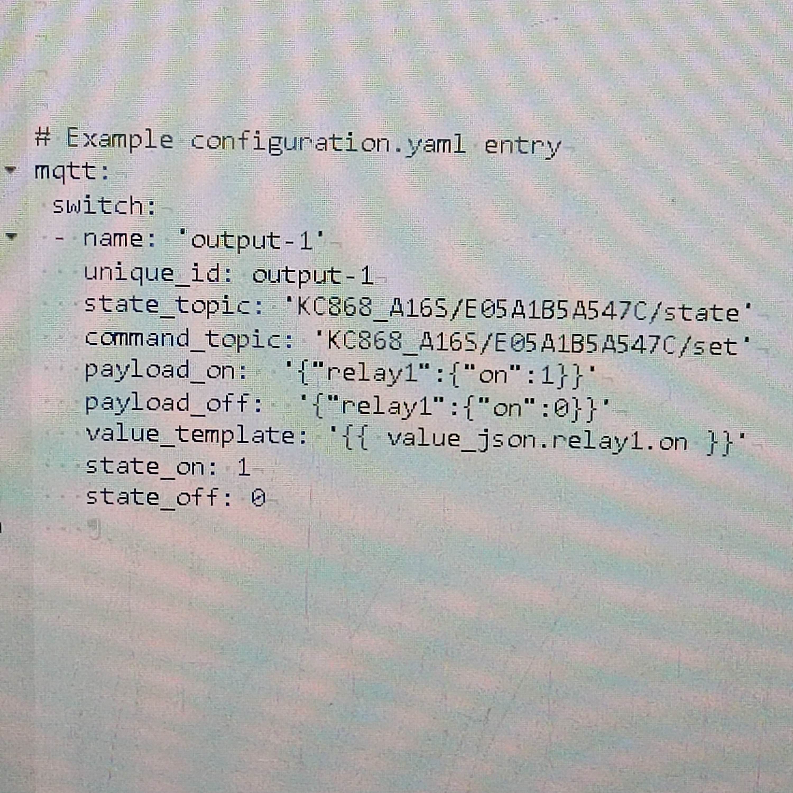

I find this code below is working using mqtt on a16s board.
- name: 'output-1'
unique_id: output-1
state_topic: 'KC868_A16S/E05A1B5A547C/STATE'
command_topic: 'KC868_A16S/E05A1B5A547C/SET'
payload_on: '{"output1":{"value":true}}'
payload_off: '{"output1":{"value":false}}'
state_on: 1
state_off: 0
