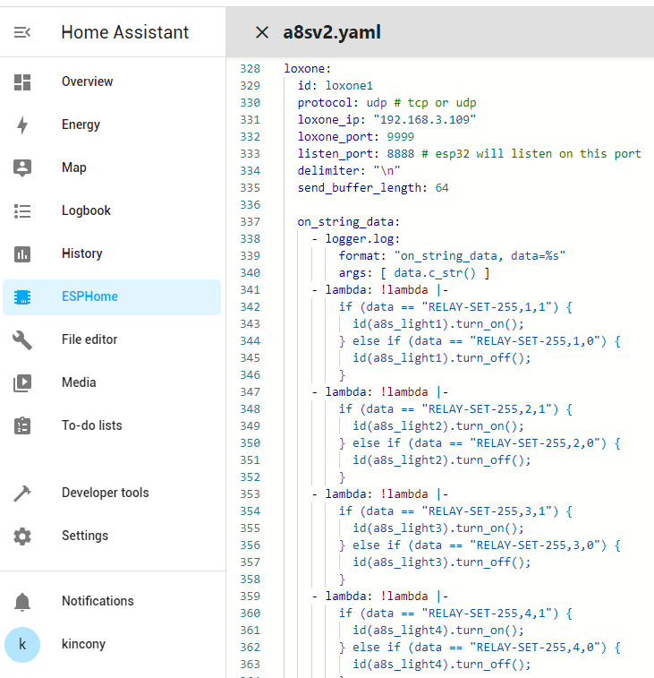

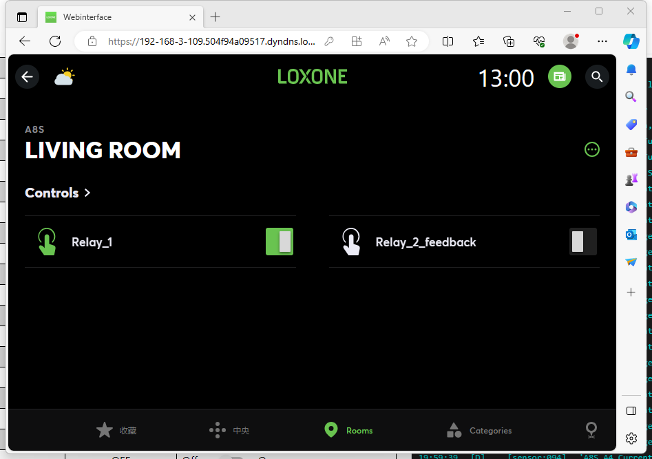

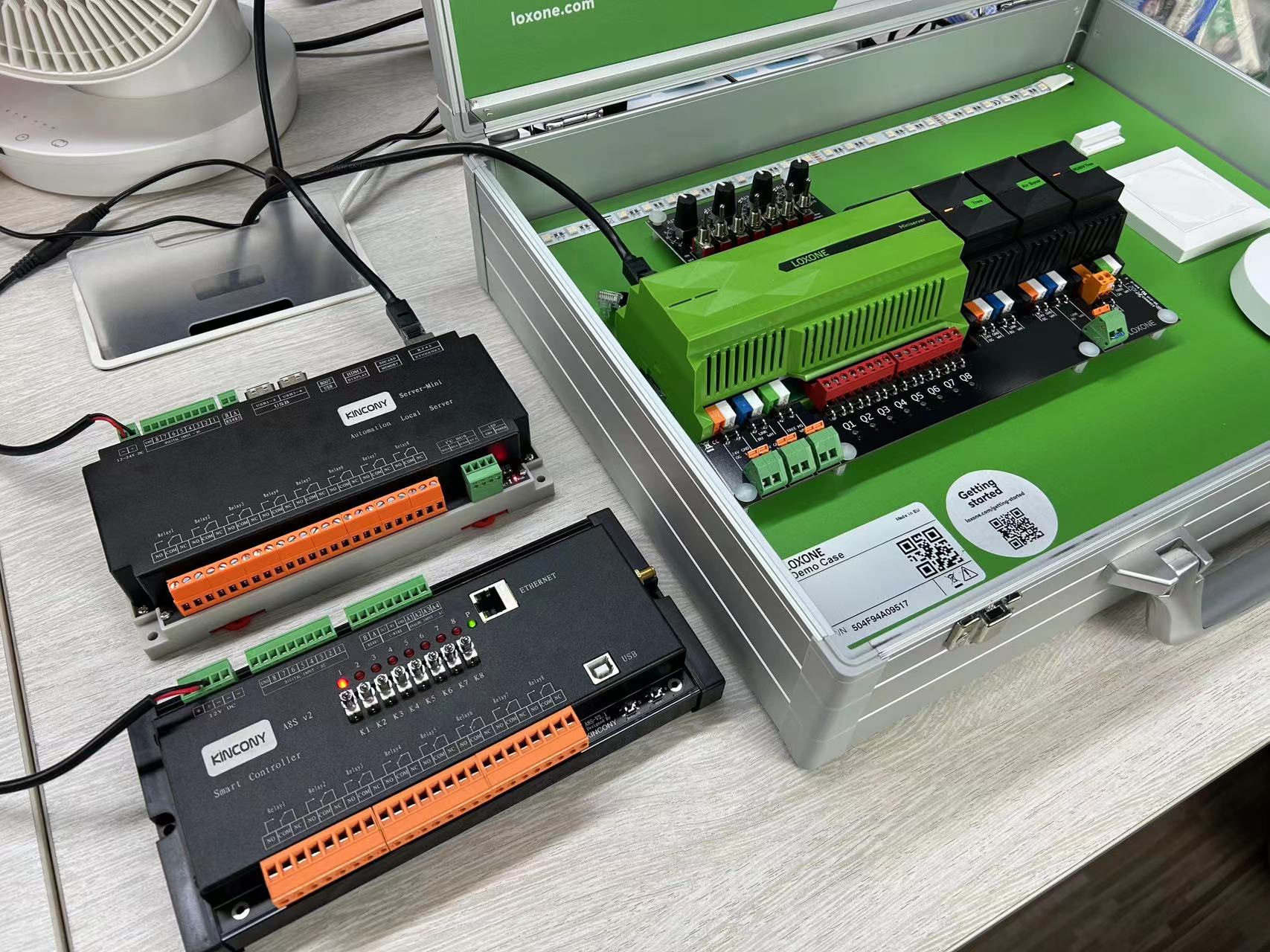

here is sample photo use by KinCony Server-mini (installed home assistant) , A8Sv2 ESP32 relay board, Loxone Miniserver. Actually you can use any ESP32 board work with Loxone and home assistant at the same time.
.txt   a8s-Loxone-esphome.txt (Size: 9.77 KB / Downloads: 946)
KinCony-A8S.Loxone project download:
.zip   KinCony-A8S.zip (Size: 29.09 KB / Downloads: 1,250)
