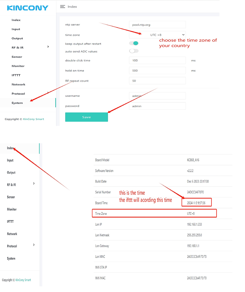

12-26-2023, 12:48 AM
list your quesiton details. upload setting image is better.
12-26-2023, 03:02 PM
12-26-2023, 11:45 PM
take a phofo of your INDEX webpage. do you have set the time zone firstly?
01-01-2024, 08:17 PM
01-05-2024, 02:08 AM
Set the time according to your country's time zone
If the time is set correctly, it can be executed regularly |
