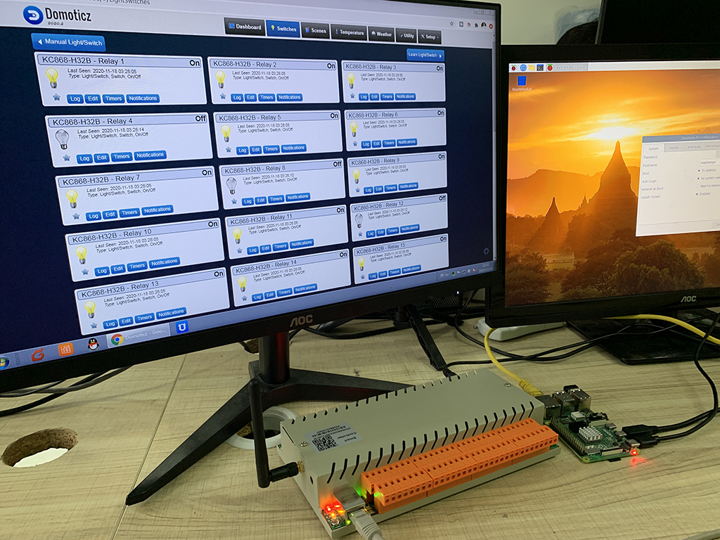

We have write plugin file for domoticz. You just need 4 steps integrate KC868 relay controller into domoticz smart home platform. It’s very easy.
1. Make sure you have a Raspberry Pi and installed domoticz. Here is Wiki for how to install domoticz on Raspberry_Pi 2. Download KC868 plugin file unzip and copy “KC868” folder to your PI /home/pi/domoticz/plugins ![]() 3. Find your KC868 Controller’s IP and Port. 4. Open domoticz website, goto menu “SETUP” — “HARDWARE” — Add KC868 Smart Controller. ![]() ![]() “Type” chose “KinCony KC868 plugin” ![]() Chose your KC868 Smart relay controller’s Model ![]() Now you can see 32 switches and 6 input port for sensor use. this is an example for KC868-H32B relay controller.
