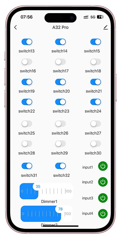

A32 Pro ESPHome yaml for home assistant and Tuya app work simultaneously without MQTT
  friendly_name: a32-Pro-arduino

  - platform: tuya_wifi_mcu
    name: A32 Pro Switch30 Tuya
    dp_id: 130
    # hide from homeassistant ui
    internal: true
    bind_switch_id: "a32_pro_switch30"
  - platform: gpio
    name: A32 Pro Switch31
    pin:
      xl9535: xl9535_hub_out2
      number: 16
      mode: OUTPUT
      inverted: true
    name: A32 Pro Switch31 Tuya
    dp_id: 131
    internal: true
    bind_switch_id: "a32_pro_switch31"

.txt   A32_Pro-ESPHome_arduino_type.txt (Size: 21.88 KB / Downloads: 696)
external_components:
- source:
type: git
ref: v1.1.0
with new code version:
- source:
type: git
ref: v1.3.1
