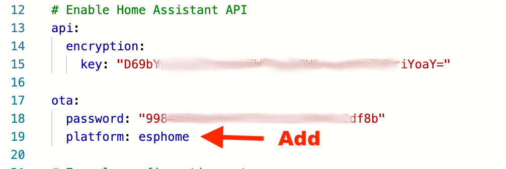

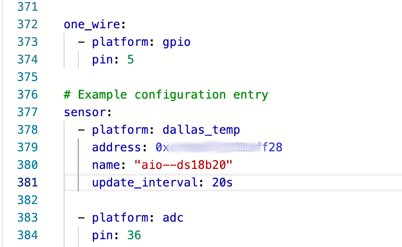

Check your indents and spaces and double check the device code it finds in the log when you install the update. I assume you know each sensor has a unique device code. Here is a screen shot of what I did to my KC868-AIO board's code, so the code line numbers will be different, too. Good luck!
Telewizard13
Did you add the "platform:  esphome" under the #Enable Home Assistant API" section? Did you restart the board and Home Assistant? Some changes don't take effect until you do.

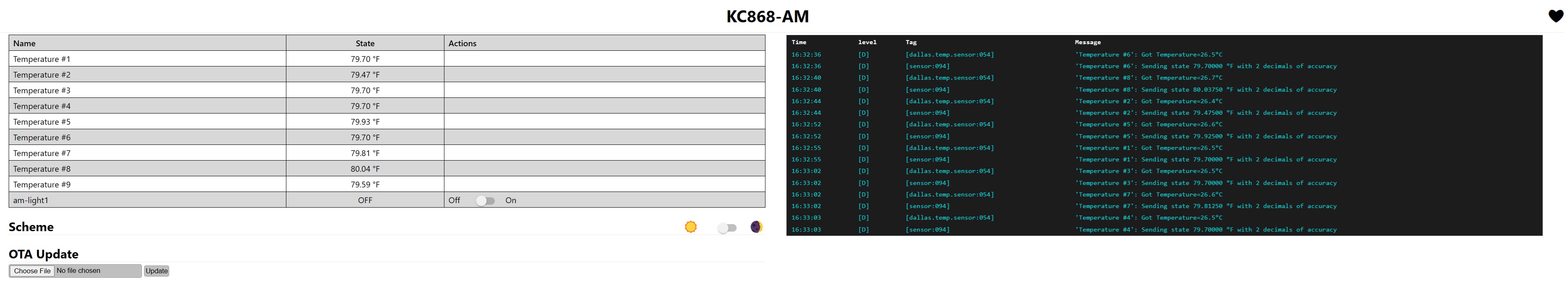

Then your dallas sensors on gpio13 & 14 will be recognized. I have attached a working KC868-AM YAML file with nine ds18b20 sensors and they all work. Just change the address to yours.
.txt   kc868-am ESPHOME 2024.6.1.txt (Size: 4.66 KB / Downloads: 810)
