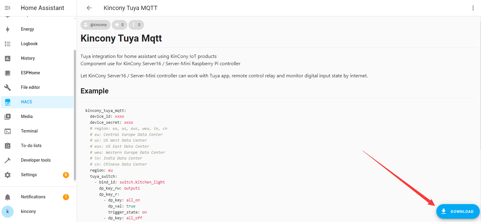

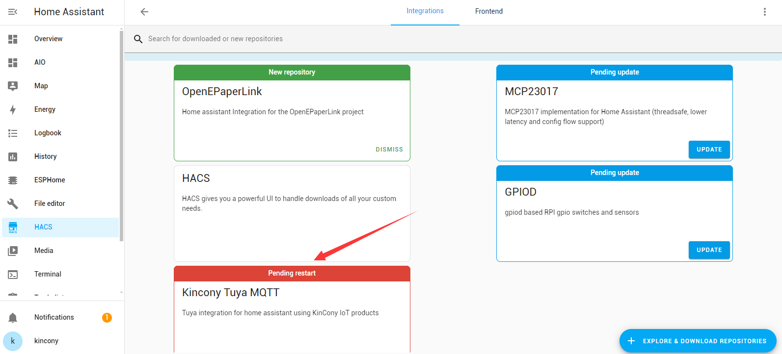

1. add Kincony Tuya Mqtt component to home assistant by HACS
https://github.com/hzkincony/hass-tuya-mqtt
2. edit configuration.yaml add the code as sample code:

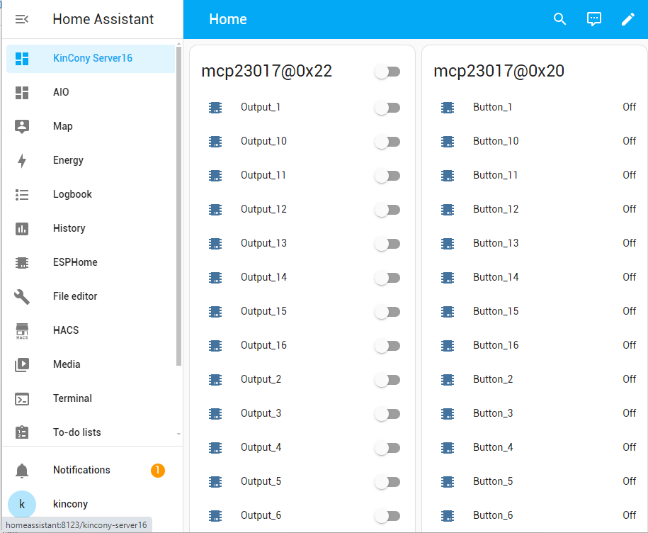

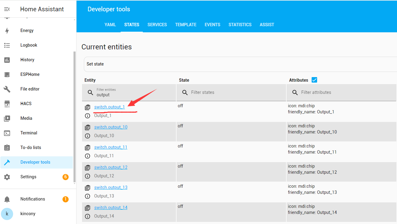

"bind_id" for switch and binary_sensor, you need search in home assistant -- "Developer tools"--"STATES", input your entity name, then find the ID name.

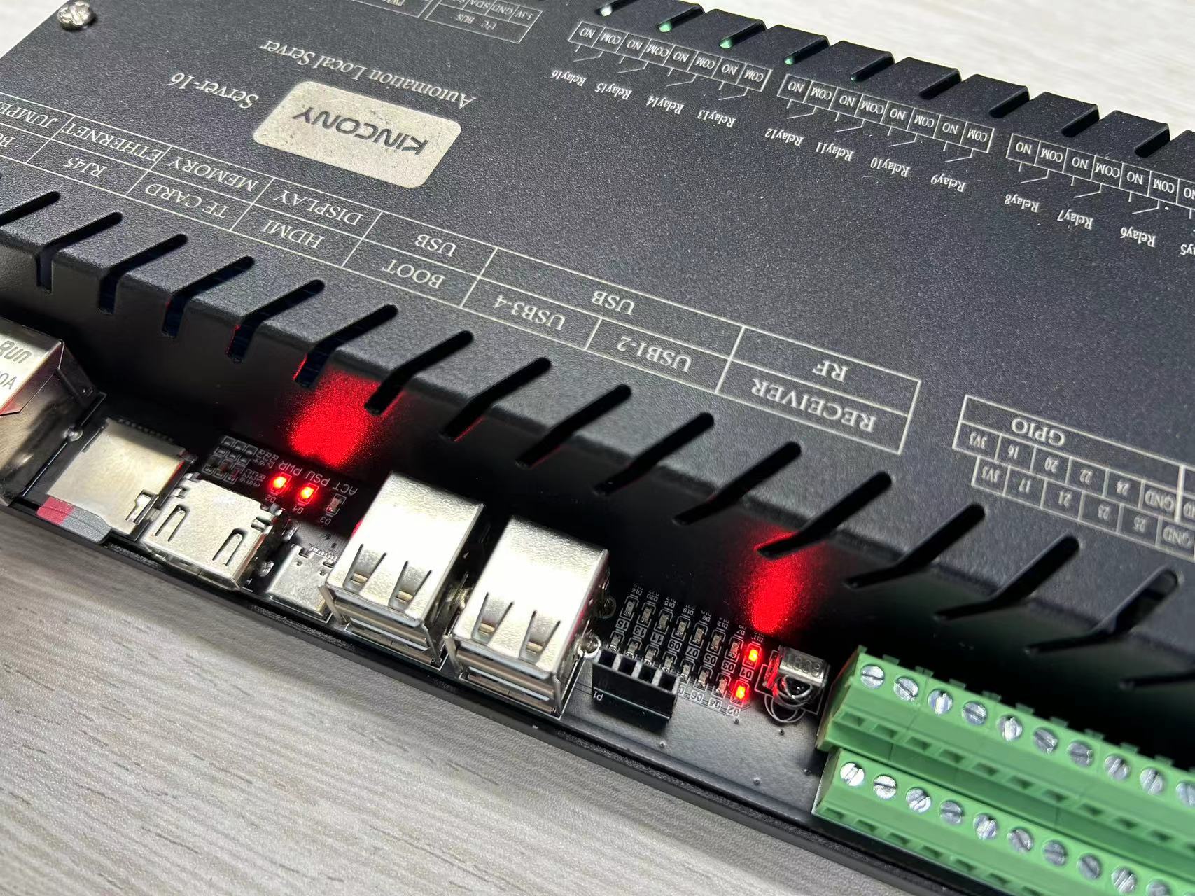

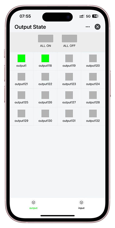

here are test photo for turn on relay1,2.

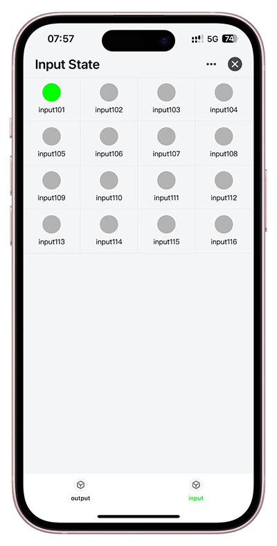

here are test photo for short digital input1 with GND.
