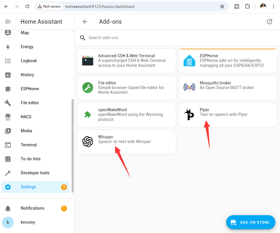

To set up voice assistant, we would need two components to create the Voice Assist pipeline in Home Assistant.
Whisper: For speech-to-text
Piper: For text-to-speech
1: Whisper Addon
2: Piper Addon

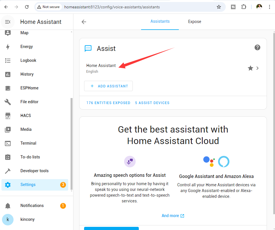

3: And finally the entire Voice Assist pipeline.
You don't need to set up the Wake Word addon, as we will use the on-device Wake Word detection with the Micro Wake Word framework
So make sure to watch it and set up the Voice Assist pipeline

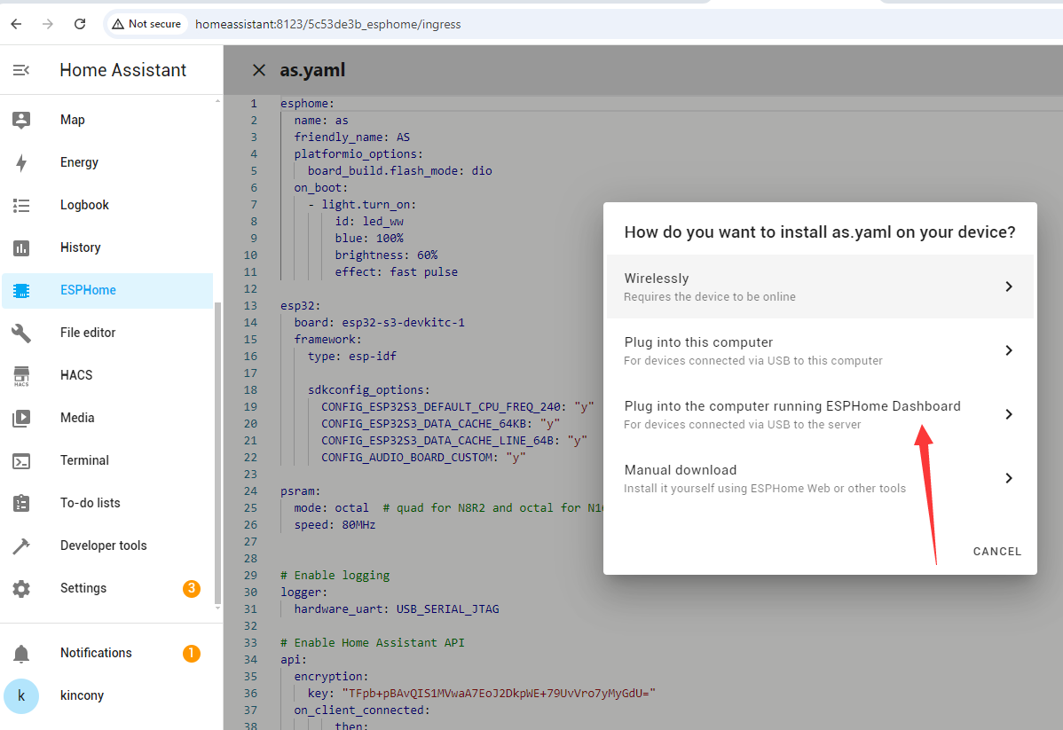

click right top windows "install" button, then will show you install way, chose "Plug into the computer running ESPHome Dashboard" item
click "USB=JTAG" option that detected.
ESPHome begin compile and download firmware:
